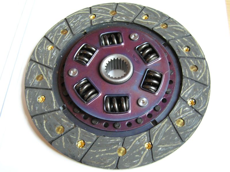

I just fittet a brand new TODA Sports clutch to my stock 115hp 4A-GE 16v. But if I rev the engine up, and release the clutch in 2. gear, the clutch just fates. Even on wet tarmac doing donuts.
Does anyone have the same problem with this clutch???
It is Exedy who made the pressure plate. I have a TRD clutch for my 20v, and it is also an Exedy pressure plate. Of course the 16v clutch is a bit smaller. The clutch disc is not the same as TRD. The TRD looks more professional. Should I buy a TRD clutch insted?

Is that a TODA clutch? It looks exactly like the Exidy clutch that was on my car when I bought it. Same colour and everything.
i dont know about mixing and matching 20v/16v pressure plates and clutch plates, but I do know that a lot of flywheels are in serious need of resurfacing after all these years of duty.. and almost nobody ever takes the trouble to do this. This might be part of your problem.
09-04-2006, 07:07 PM
Problems with TODA clutch
Yes, its a TODA clutch. But made by Exedy.
I did not resurface the flywheel, just grinded with some rough sandpaper. I think I will order a new TODA flywheel insted. Tongue
