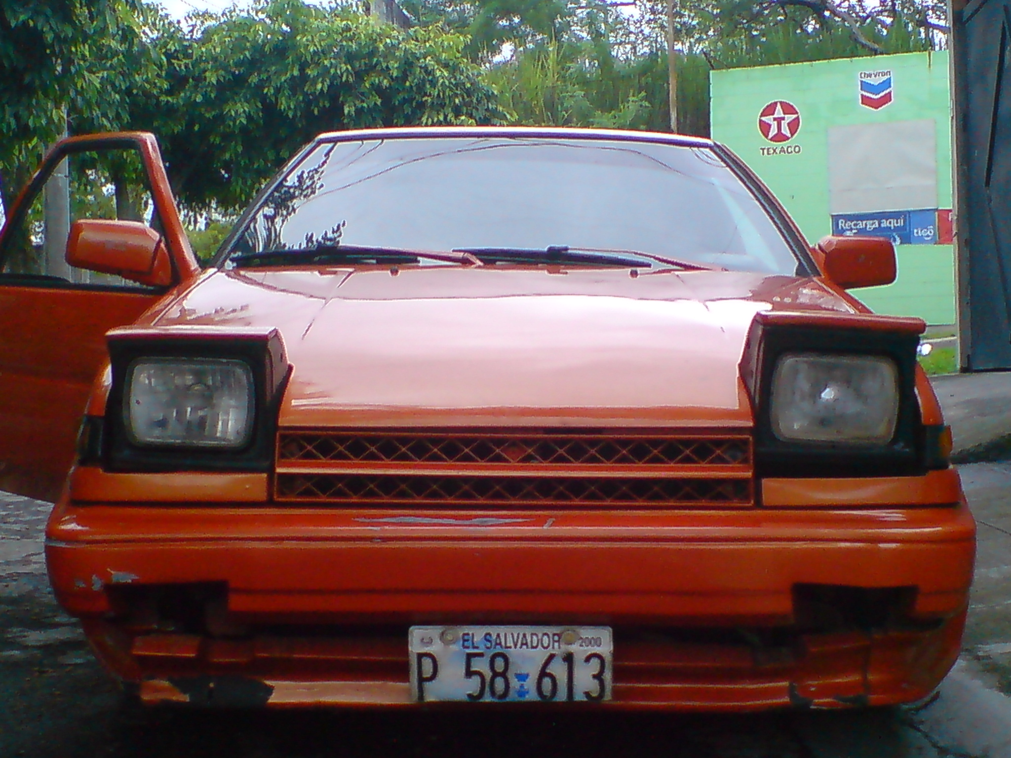

Hey guys i don't know if it's really a problem or jus i'm the one thats looking that if you see the headlights of my trueno it seems that the left headlight its a little niot higher than the right one so if it's a problem can anybody tell me how to fix it please[img name=]http://www.aeu86.org/files/ds/dsc00998_676.jpg[/img]

I think it's not only a bit higher, but also a bit sloped to the left...
I think it's best you adjust the whole unit (mounting to the chassis). There are two screws on the front and (as far as I can remember) two on the back of the unit. The ones on the back are the hardest to reach since you need to get through the whole unit. 1983 - AE86 Sprinter Trueno - import project 2013 - Honda Civic sport - daily driver 2004 - AEU86 dot ORG - daily domain Support our forum, buy from the AEU86 shop:

Take it all off and adjust the hight of the push-rod.
Also as Banpei said, try to bend the hole unit just a little to the right and voila
