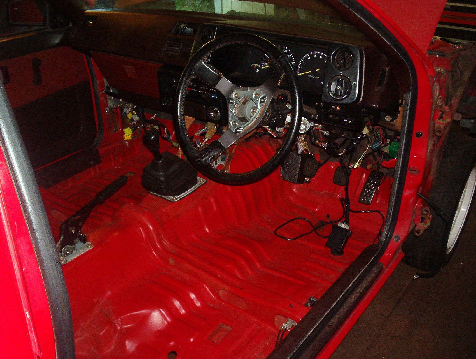

This is my ADM car (essentially like a USDM SR5) which I converted to 4AGE power about 15 years ago with an English engine loom spliced into the ADM loom. Disc brake rear end etc etc.
[img name=]http://www.aeu86.org/files/im/im000422_132.jpg[/img] Anyway, after the first child was born it started playing up after 10 years of faultless running. So taken off the road and stuck in the shed to be replaced with a Peugeot 307 family runabout. [img name=]http://www.aeu86.org/files/im/im000419_181.jpg[/img] Eventually worked out the problem, a dodgy connection at EFI relay 2 due to a massive soldered connection to the injectors. [img name=]http://www.aeu86.org/files/im/im000420_146.jpg[/img] So decided to rebuild it properly this time. In these days of Ebay and the net, sourcing parts is easy so this is now essentially in GT apex spec, or will be when all the bits are bolted back on. Have a habit of fixing or installing something then deciding to pull it off again to "improve" something. [img name=]http://www.aeu86.org/files/im/im000421_148.jpg[/img] Have made a few improvements along the way however. Don't get much of a chance to work on it so it is taking a while...... |

No not resprayed, engine bay got a thorough scrub and the inside I sprayed with a can after removing the sound deadener.
Fortunate with rust, only a little at the bottom of the B pillars. The original owner fish oiled it thoroughly and whilst stripped out, have repeated the exercise. |
