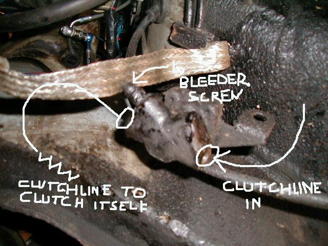

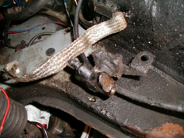

What does this "THING" do for the clutch-oil.
It it fitted 20cm before the clutchcylinder that pushes on the clutch itself.
this item also has it´s own bleeding screw & it has anshort rubber line into & out of it which supports the clutch-oil - if I remove this thing i´d be able to fit an single clutch-line all the way from the clutchmaster-cylinder = MUCH better than stock.
WOULD THIS BE POSSIBLE ?

kris i wouldn't do it...... its there not for nothing.... i've never seen this MOD on a AE86. If you go time to exchange it twice you can test it but i wouldn't recommend it without consulting race build AE86's

Don't have that thing on my car.....

I think it's just what you can see from the outside...a bleed valve. Especially if it's mounted in the top of a loop. But dont go guessing, try looking it up in EPC, I cant help you out since I'm at work..

thanxs - I have just learned what this is..
It´s a extra bleed valve / restrictor för the clutch-oil.
the restrictor allows for a smoother clutchslip.
just remove it i have been told
