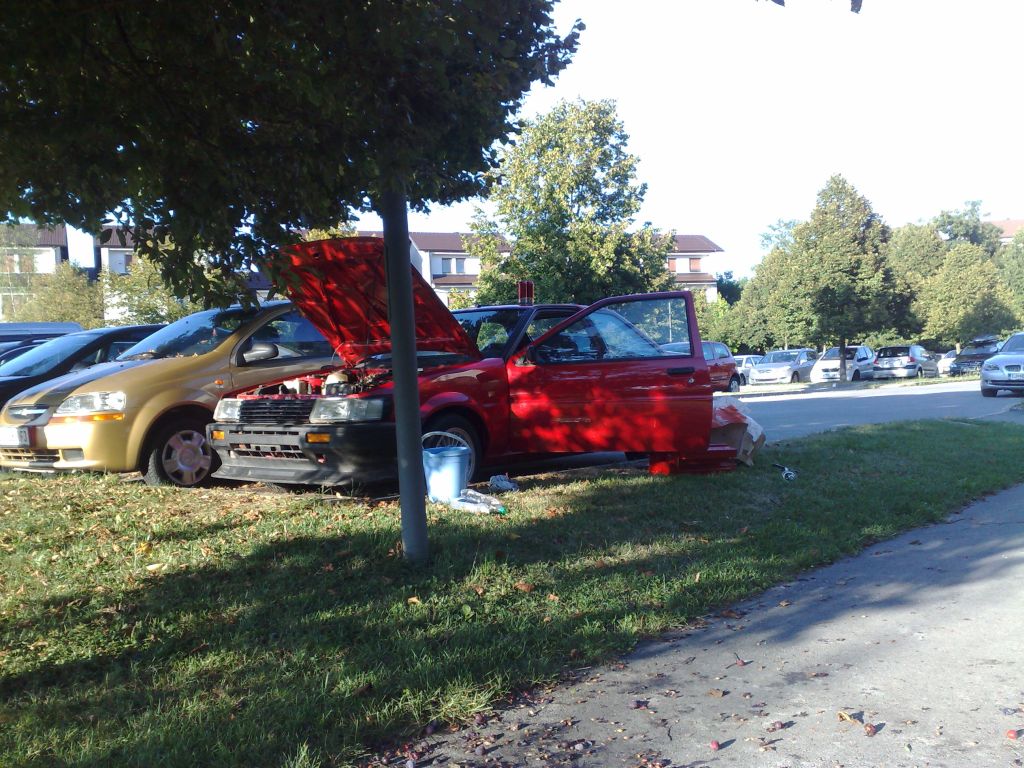

cool picture Cool
09-02-2010, 10:41 PM
Post: #222
Old Fashioned
by far the sexiest car on the parking lot if you ask me Big Grin okay my neighbours 405 T16 in the top left aint that bad either..Big Grin

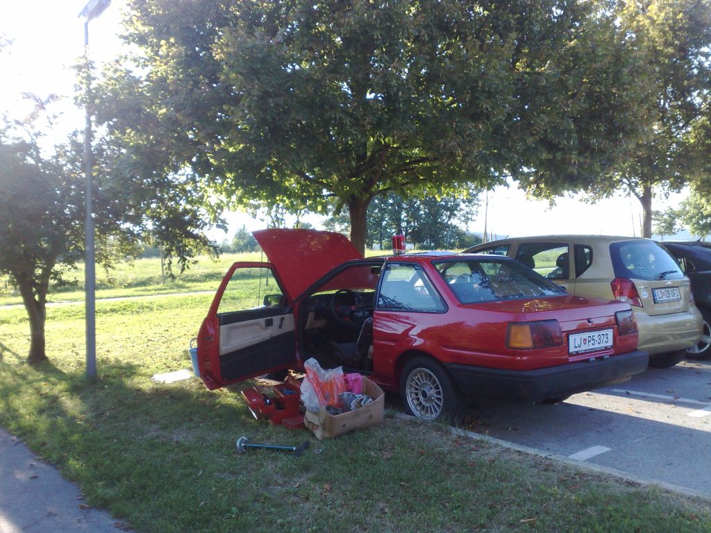

The camera the picture was taken with is certainly old-fashioned Tongue
Car looks good Apolan.. are you driving the thing now?
09-03-2010, 01:40 PM
Post: #225
Old Fashioned
Man time sure flies! Exactly 1 year ago the car was "almost" finished, the suspension was put together, engine rebuilt and returned to enginebay (longblock). All it needed was to finish the engine, and finetune the suspension, alignment, brakes, clutch etc. With the return of the car from the garage september arived and so did the work, beeing too busy (or lazyConfused) i let it sit in the parking lot for 1 year. Now two or three weeks of work almost everything got sorted out.
The engine seems to run fine, its got good oilpressure, engine warms up okay, no unpleasant noises aside from the valvetrain (i guess i need to adjust the shims), and seems to rev up nicely (didnt push it yet past 5k as it is fresh rebuild).
The brakes have been blead and seem to work fine, just need to break-in alittle as the discs are new. The alignment hasnt been done yet, as im still waiting for a new steering rack from Markus and i also ordered new inner tierods.
And finally i have a somewhat proper exhaust (one that doesnt leak and is decently quiet). I'll put up some better pictures/vids later..
So i am test driving the car alittle, i made 25 kmsBig Grin It feels preety sloppy atm as everything is new and not broken in yet. And also the alignment is way off (2 degrees diference in caster L-RBig Grin) And i already see that something has to be done with the differential as the noises coming out are preety unhealthy. It doesnt sound just like bearing problems (whineing), but like putting a cardboard piece on your bycicle and riding it. So it might be cwp issue..
Now im just waiting for that steering rack and tierods (might even manufacture a spacer to put in between for alitle more lock (advice? pros-cons?), than getting that alignment and the dreaded MOT. Than hopefully the car will be a solid runner and i can finally flollow the Mux's "1 weekend job" principle. I just want to drive the thingBig Grin
