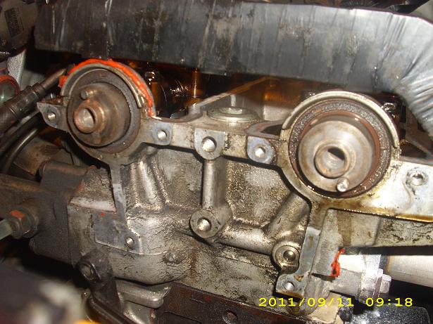

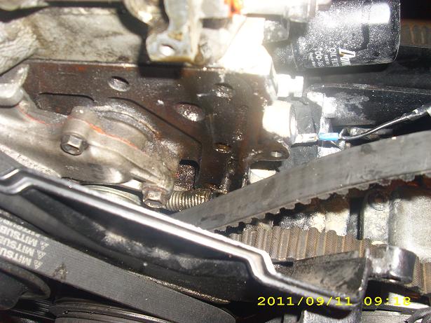

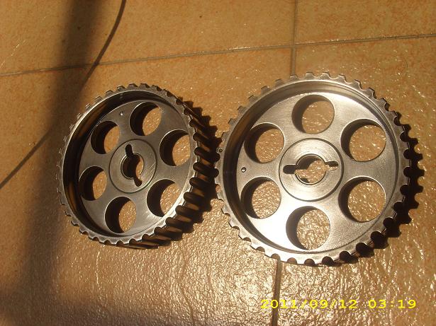

dear all master. after open all the part, finally found the main leakage point. u r right ~ is from the crankshaft oilseal. as per advice i change both at hte same time. For information, the oil seal part number as 90311-35013 or for simple english is oilseal TC-35-49-6. it cost me RM12/pc.
Now still under observation on the leakage issue. godbless. below as some of the photo taken during oilseal change.
