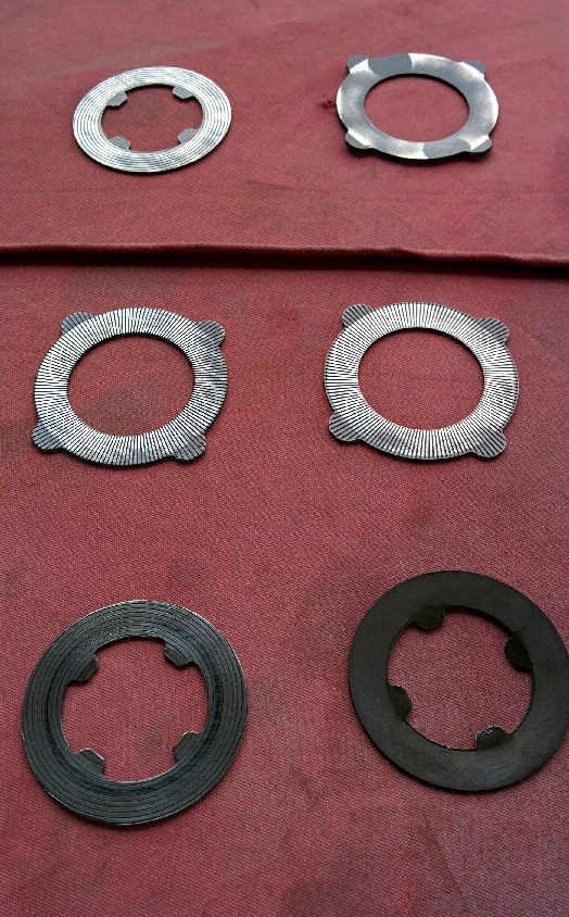

Yes looking at all plates that I have they seem more like t d ones than others. Must be due to being a JDM model.
Round edged cluch n spacers/washers.
(07-11-2014 04:34 AM)allencr Wrote:  It should take a VERY LONG TIME to wear out those plates.
Did they pre-soak them & assemble it using plenty of lube on them?
The diff was never removed by the looks of it so ideally the diff should be as old as the car and the clutch plates the same.
(07-11-2014 05:40 AM)heshan Wrote:  Yes looking at all plates that I have they seem more like t d ones than others. Must be due to being a JDM model.

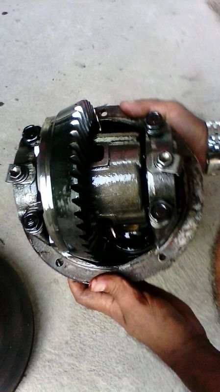

pics of the diff
Anyone can tell what this diff is by looking at it or tell me how to identify what the exact diff is?

07-11-2014, 10:07 AM (This post was last modified: 07-11-2014 10:16 AM by totta Crolla.)
OEM LSD Question
From the casing it looks like a TRD unit.
My TRD differential is noisy when using SAE 90 oil.
The pictures contained in the post below should help you to confirm, notice the rough surface of the casing on the TRD compared to the OEM diff.
http://www.thaiscooter.com/forums/showth...7-cw_ldVKs

75W140 LS only.
It looks like TRD unit:
[Image: AEU86 AE86 - OEM LSD Question][Image: AEU86 AE86 - OEM LSD Question]
07-11-2014, 10:35 AM (This post was last modified: 07-11-2014 10:36 AM by Ivan141.)
OEM LSD Question
TRD indeed, that changes the picture quite a bit.. that wouldnt break anywhere near as easy as an old OEM diff would, and it can make more noise.
BTW, I've never heard of factory fitted TRD LSD's...very much doubt it has been there from the factory.
