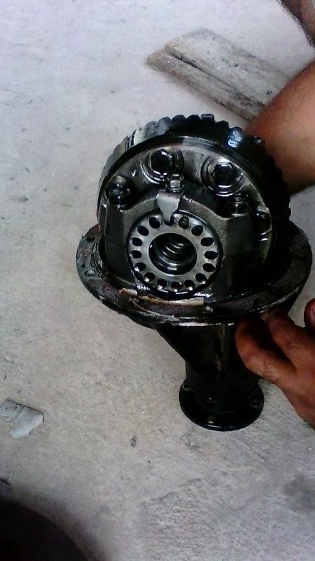

07-11-2014, 07:18 AM
OEM LSD Question
pics of the diff
Anyone can tell what this diff is by looking at it or tell me how to identify what the exact diff is?
07-11-2014, 09:17 AM
OEM LSD Question
http://www.ebay.com/itm/JDM-TRD-LSD-Repa...9f&vxp=mtr
link which made me think that mine is a factory fitted TRD unit.. Its tough to find info on this JDM LSD unit..
07-11-2014, 10:07 AM (This post was last modified: 07-11-2014 10:16 AM by totta Crolla.)
OEM LSD Question
From the casing it looks like a TRD unit.
My TRD differential is noisy when using SAE 90 oil.
The pictures contained in the post below should help you to confirm, notice the rough surface of the casing on the TRD compared to the OEM diff.
http://www.thaiscooter.com/forums/showth...7-cw_ldVKs
07-11-2014, 10:25 AM
OEM LSD Question
I used to use 85w90 Toyota oil. What do u use?
07-11-2014, 10:26 AM
OEM LSD Question
75W140 LS only.
It looks like TRD unit:
[Image: AEU86 AE86 - OEM LSD Question][Image: AEU86 AE86 - OEM LSD Question]
07-11-2014, 10:35 AM (This post was last modified: 07-11-2014 10:36 AM by Ivan141.)
OEM LSD Question
TRD indeed, that changes the picture quite a bit.. that wouldnt break anywhere near as easy as an old OEM diff would, and it can make more noise.
BTW, I've never heard of factory fitted TRD LSD's...very much doubt it has been there from the factory.
