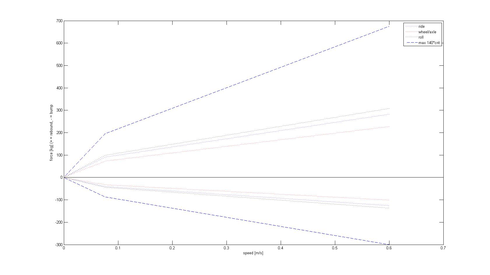

SETUP 1: Standard Tokico HTS AE86 dorifto.
First we calculate the demands from the springs and chassis. The following graph shows the various modes 65%->40% critical damping forces and the 140% critical upper limit:
[Image: AEU86 AE86 - Nohachi's suspension ramblings thread]

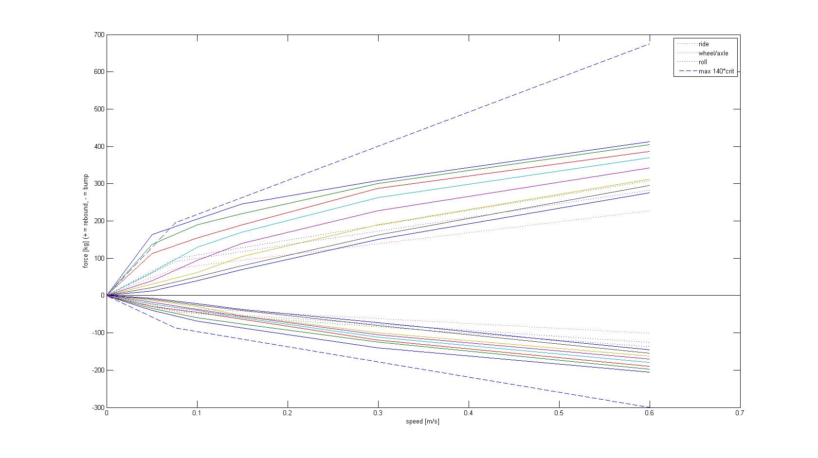

Now we show the same graph, but we overlay the dyno data from the HTS shown on page one of this thread.
What do we see in this mess?
Well first that the HTS does indeed fall in the range between 0.5 and 1.4% of critical damping. That means that we should be able to get handling dialled in using these shocks! excellent..
The three softest settings are underdamped in both bump and rebound for optimum handling. But they are right on the curve for the high speed stuff. My guess is this feels a bit squishy when steering, but about as comfortable as you can get 8/6 springs.
Settings 4 and 5 are OK. My guess is this is what most people end up with if they adjust them based on overall feel.
6, 7, 8 are towards the overdamped range of the spectrum, but overall not bad at all.
My guess is that there is only 1 kind of HTS valving used in most if not all applications. The 86 valving seems optimised for a slightly heavier car then the AE86, probably perfect under a 1200kg 240Z. But they are suited to the 8/6 sprung AE86 very well indeed.

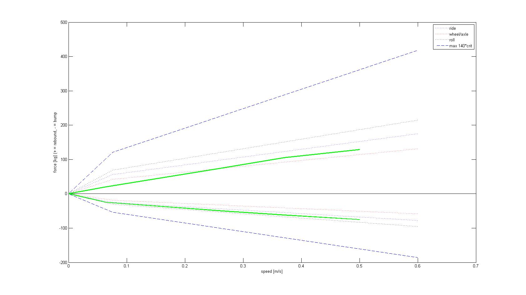

SETUP 2: JONDEE BILSTEINS.
Interestingly enough, Jondee was kind enough to post some data on springrates and dyno curves that were recommended to him by the local Bilstein specialist. Springrates are 3.0/2.8:
[img name=]http://www.aeu86.org/files/jo/jondeebilstein_270.jpg[/img]
Strangely enough they are digressive on the bump stroke in stead of rebound. I've seen most shocks valved the other way around but don't know how this works out in practice.
From the graphs we can see that the damping rates are just about perfect during the bump stroke at all speeds. Rebound damping is spot on at high speed, but seems to lack low speed control. Probably a consequence of having a piston that allows only one side to be digressive. The numbers suggest that the setup might need some more rebound force.
