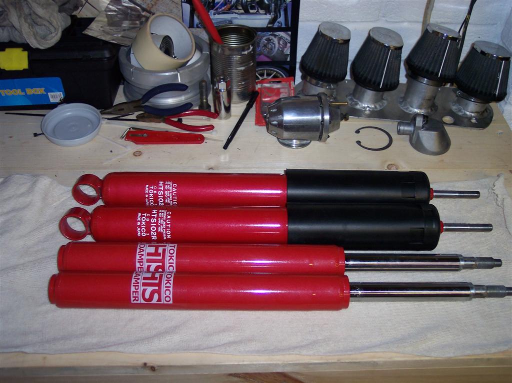

Hello again folks...
The new Tokico HTS suspension arrived this morning. My car should be sweet again by the weekend ready for silverstone.
Anyone know a source that I could get some of the tokico bolt on adjusters for the tops of the dampers from - will save needing the adjuster tool ?
Regards Ian.
