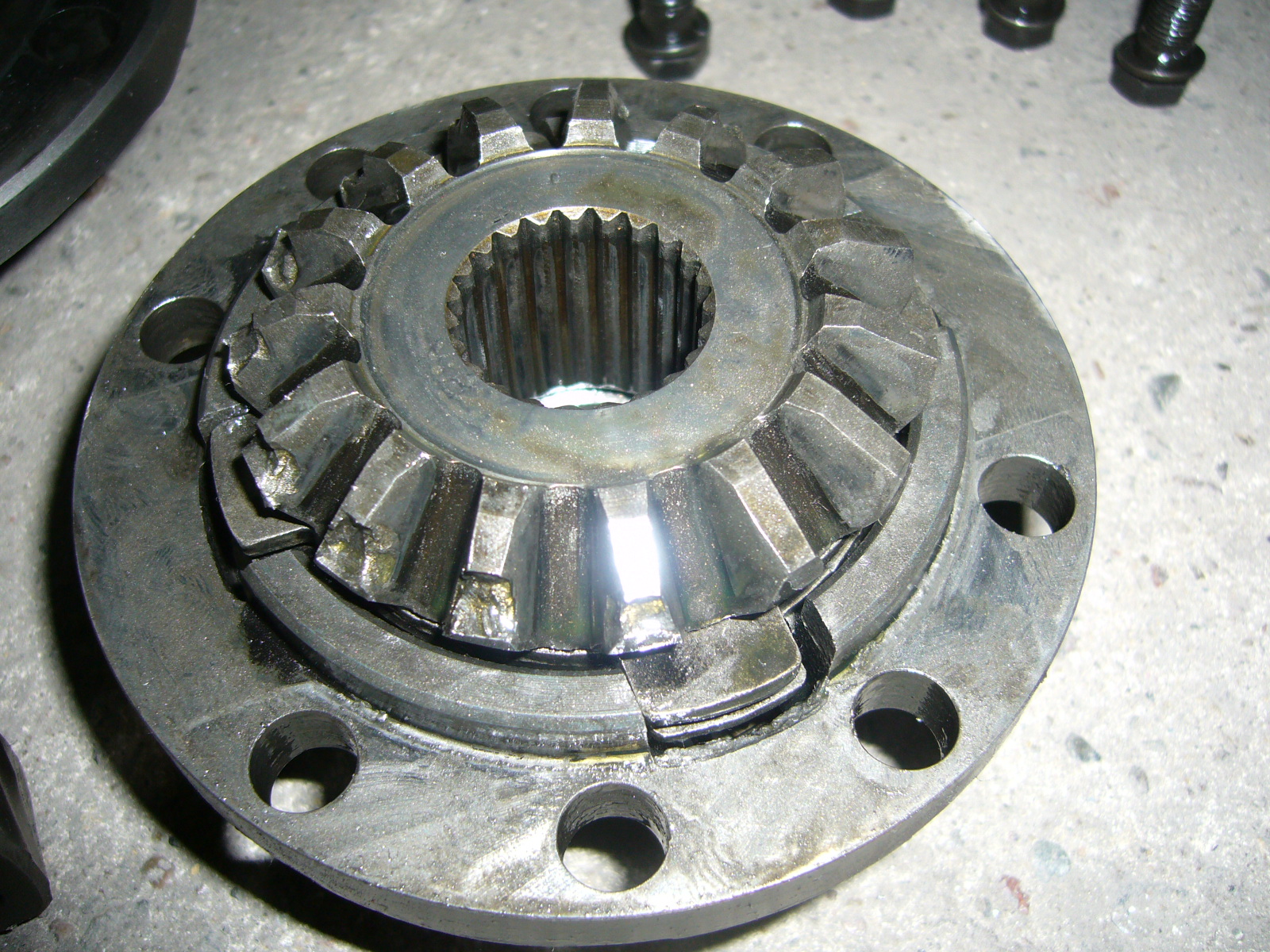

Damn that is a scary idea, well you wanted to upgrade LSD at some point anyways, interesting to hear the RNP was in good shape as it does make some sound.
Anyways, sounds like we both got lucky, if parts start floating around within the LSD god knows what would have happened.
Also thanks on the news that the prothane bushings (they aren't powerflex) are still in good nick, they have been on the car for 2 or 3 years now and taken to daily abuse. Proves they are a quality productSmile
You're really going to feel those uniballs though. i remember Banpei had uniballs on his car for a little while...

I am very scared about those uniballs. It wasn't best choice for meSmile
Here you go some pics of LSD Wink

Owh man amazing! I've heard of this happening before. But its scary to think about me having driven around with this fault for some time....
As for the unibals, well you have some perfect condition 4 links with prothane to go back to if you don't like emBig Grin

how do you thing - would it work so good if it would be FIAT or DAEWOO? ;D
do you still thing that this souind of knocking was RNP?Wink

No I fear the sounds was definitely the LSD. Allthough wining sounds are usually from the RNP.
But it is a testemant for Toyota, they just keep on going even when things break...
