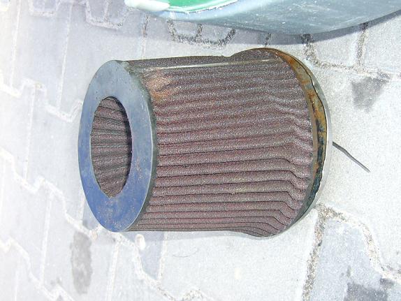

Hi everyone!
Today only good news Smile
I've repaired the damper, and I adjust the suspension.
I maked it 5 turns and its really surprisingly good! It's stiff but works on wholes. I wont change it now its really good!
so info for you guys: dont EXCITE to much, It stays with me!!Big Grin
I've changed intake filter - old looked like after WW2. Incredibly dirty and ulgy. Immediately i felt the difference - now car can breath normaly!
After that I washed the engine.....(pic before cleaning)
Somewhere near header came out a hole - a little of exhaust gases gets to the cabin and it has nice sound Smile I'll do it in next week when I'll get back home.

Great that you changed the filter, that was indeed long overdue, its been on the car for well over 4 years.
Hmm, a hole in the header? Thats not good. Well you got the OBX header so that should fix it up nicely. The header is still the original one and I never removed it.
You should dyno it when you get the header on. Even with the old filter and the current exhaust last time I dyno'ed it, I got some real nice figures. Though everyone still claims that it must be the dyno that was wrong Smile
