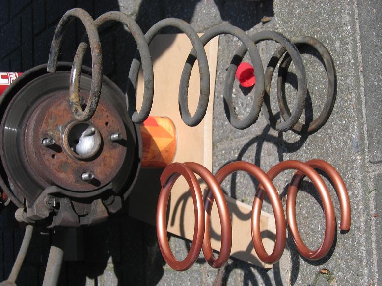

robokill Wrote:Becuase the trd springs are alot lower than standard ones. (check the hight and compare it to the trd srpings!
To give you an example of aftermarket springs next to standard springs. (B-Tune/Swift 4.5kg/mm)
[Image: AEU86 AE86 - My Project has started...]
