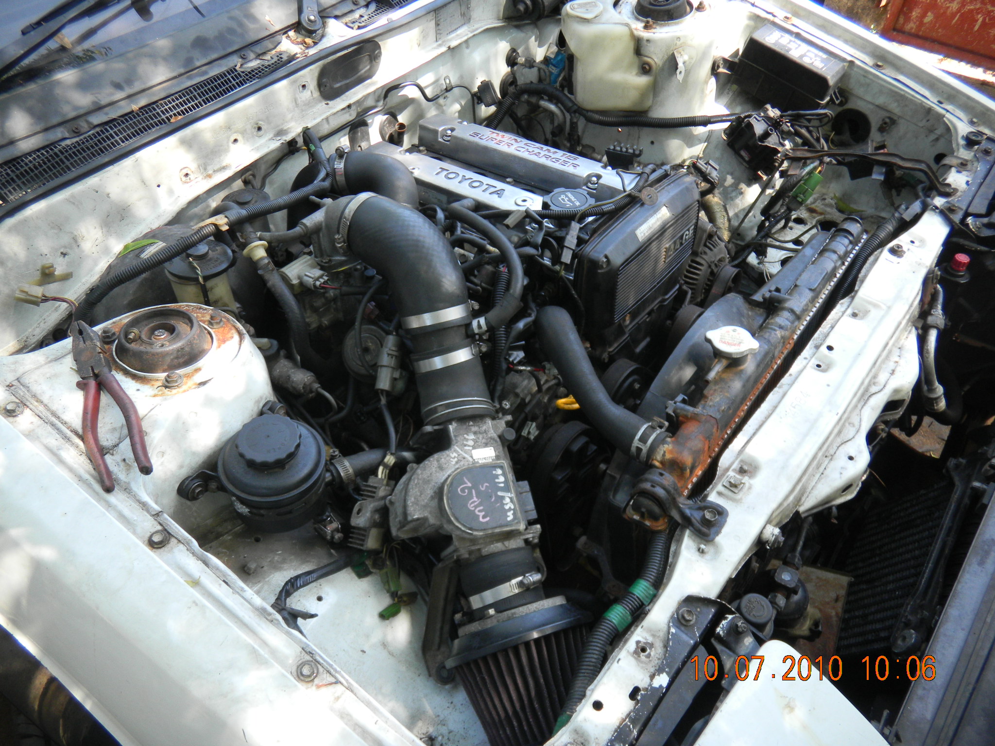

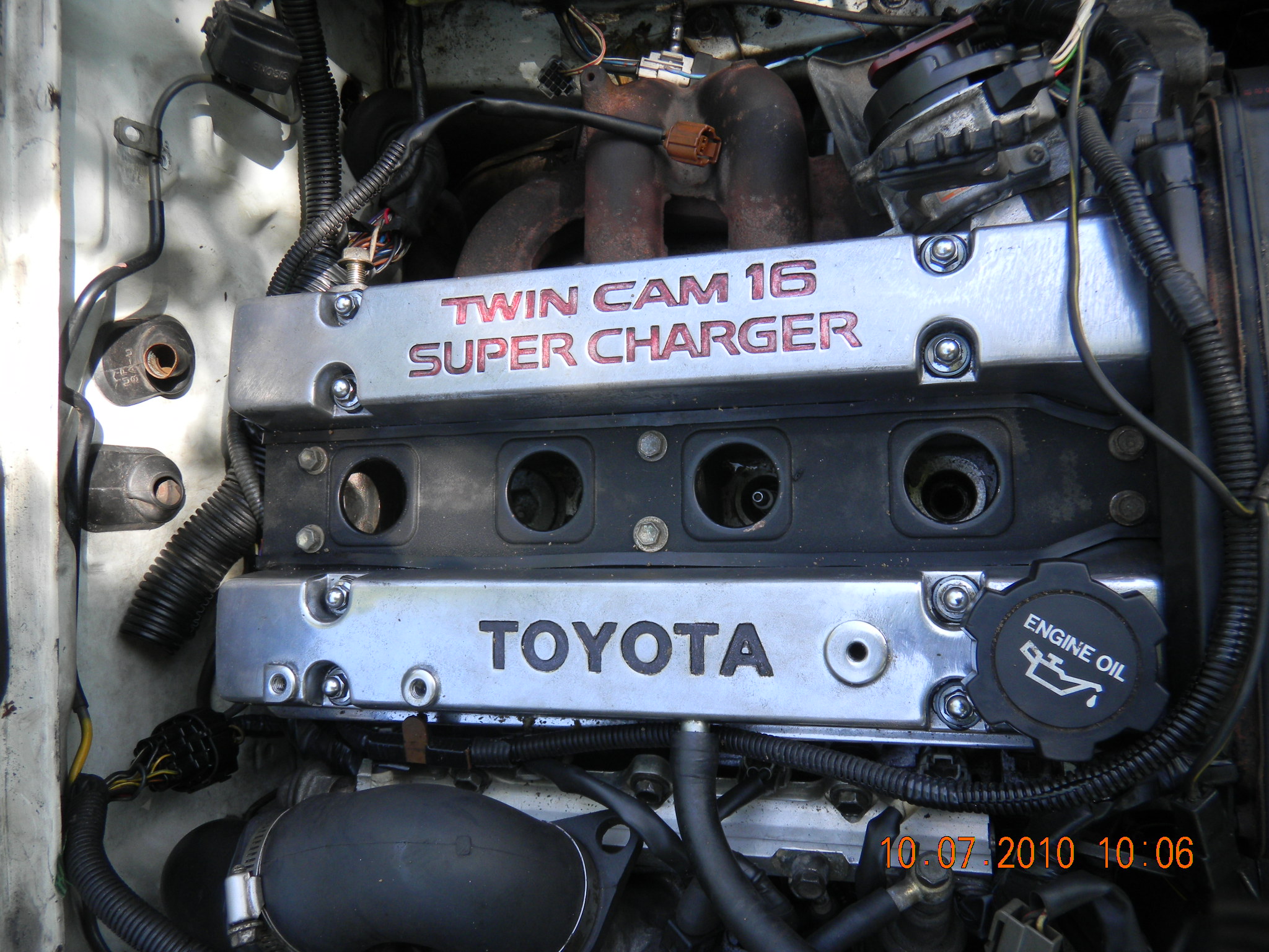

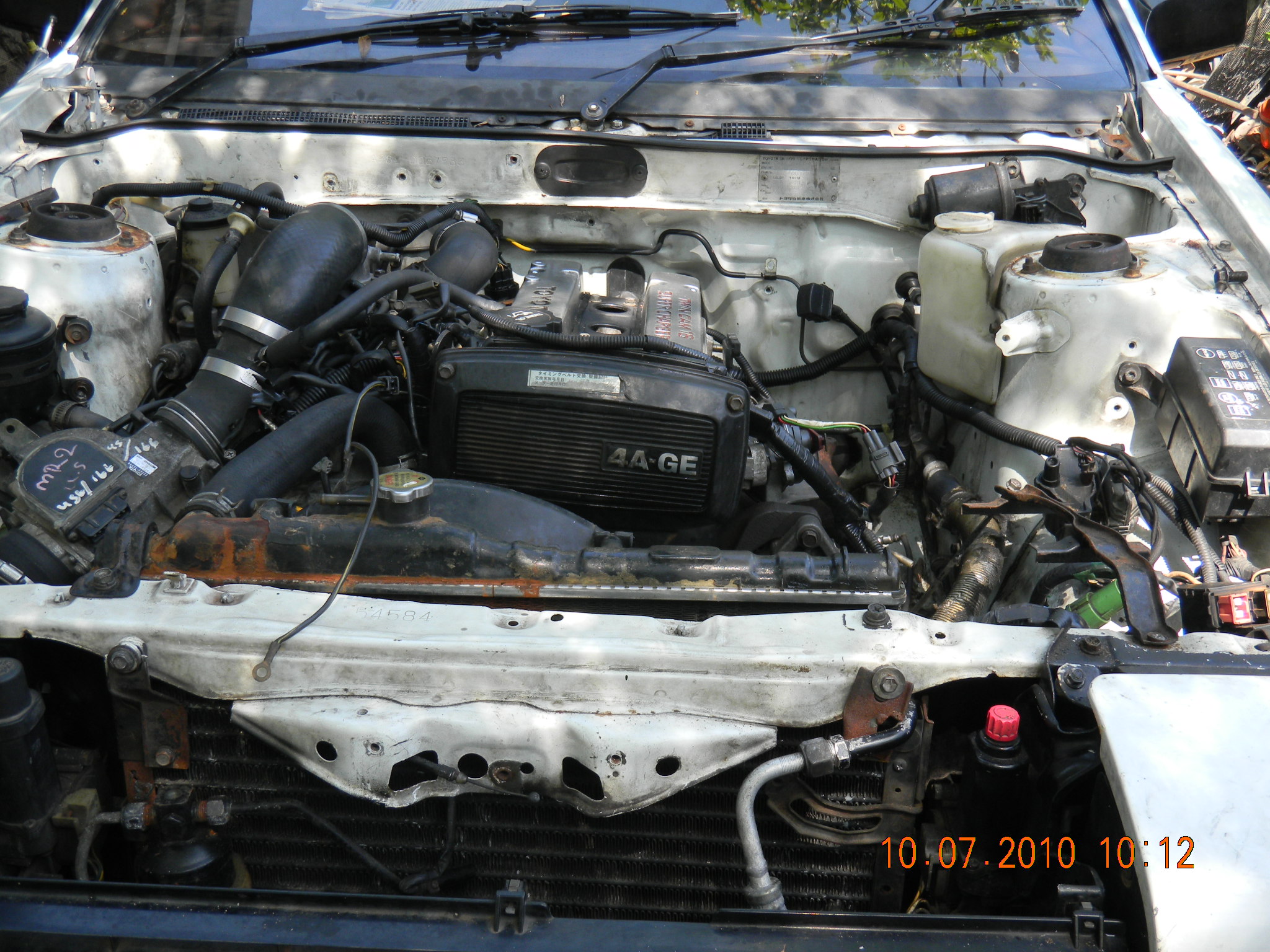

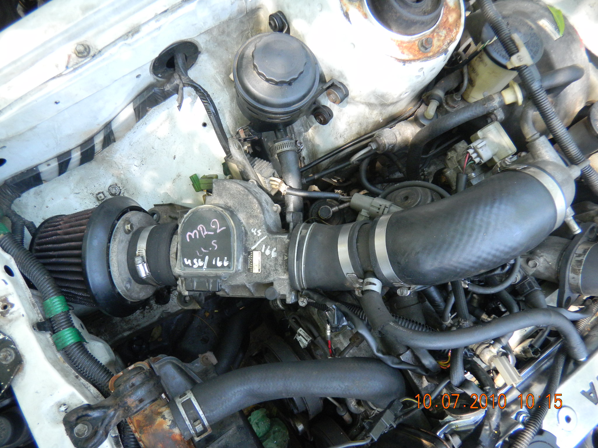

07-10-2010, 02:46 PM
My AE86's 4AGZE Swap (Sri Lanka)
To be done... FMIC... Radiator upgrade...
