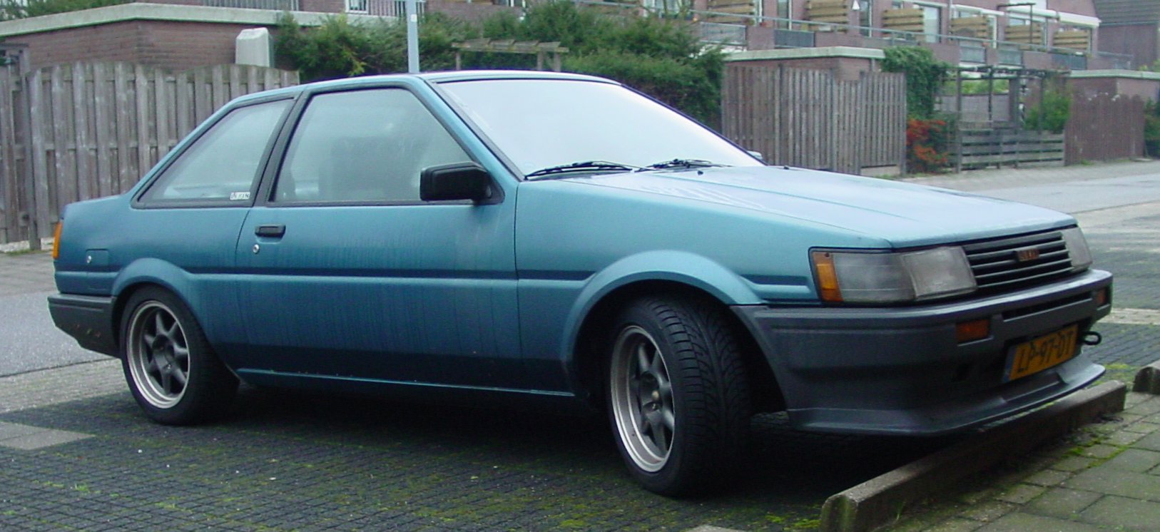

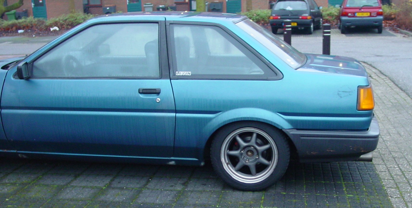

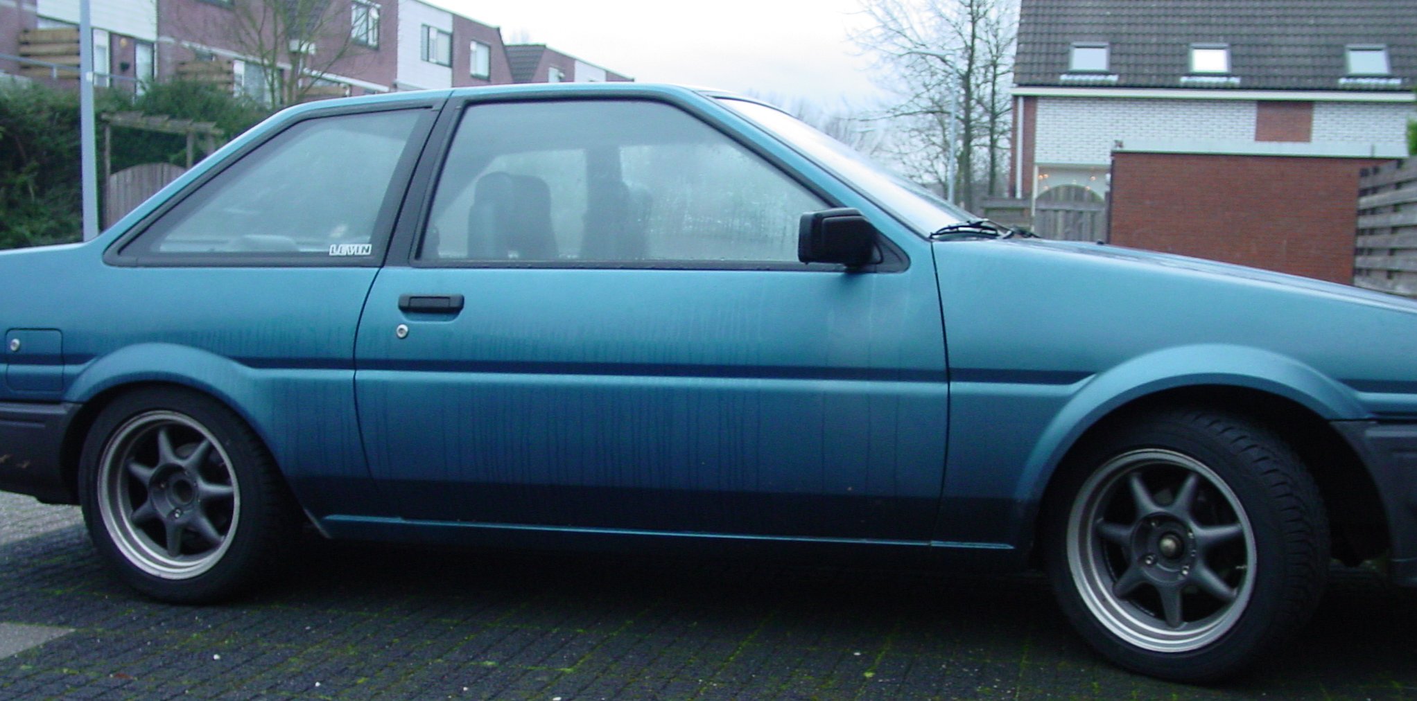

12-21-2006, 12:13 AM
Post: #365
Mux213 Levin GTS
Kept you guys waiting long enough...
Finally took some pictures of my car with the new rear springs. As you can see my car is at a weird angle right now. But it drives soooooooooooo goodBig Grin
I haven't had time to do the shortstroke conversion at the front yet, will do a writeup when I finally get it done...

12-21-2006, 01:07 AM
Post: #368
Mux213 Levin GTS
Sutter,
No shortstrokes in the rear, just planning them for the front right now. Thought its definately something I'm thinking about for the future, this will not pass MOT.
Banpei, yeah too low which is why I'm hoping Jamie will hurry up with those spacers Smile
