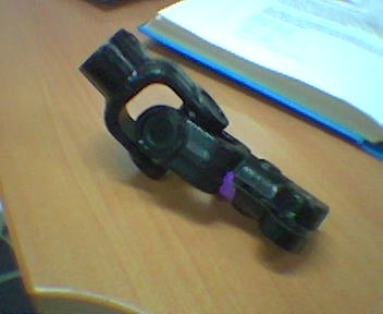

I failed the MOT just now! The car was perfect, mechanic was very pleased with the car. But then he found some play in the steering. Turns out the lower U joint on the steering rod (the one connecting it with the horizontal bit of the steering, not sure how its called) has a tiny tiny little bit of play... So it needs to be replaced.
Now for the real shocking part, Toyota has quoted me 150 euros for the damn thing!!! Well I put down the order but if someone know a place where I can get them cheaper and within a week (MOT runs out start of next week so idealy I want to replace the joint this weekend and recheck after the weekend) then I probably can cancel the order if I know by today.

150 euros.........
I must say, it does look way more solid then my tiny rusty one I have now.. Gonne see if I can swap it over tonight, or maybe tomorow.
Friday I go back to the MOT guy. I asked them today about an appointment, they said, when you put it on your car, drive by, we look at it, if tis good, you have MOT. So I guess they are not rechecking the car by muchSmile
I'll let you guys know if my steering really improves with this. I guess its one bit less of rust to worry aboutSmile
(one thing though, for 150 euros, you'd think they would include the two bolts that go with it....Wink )
