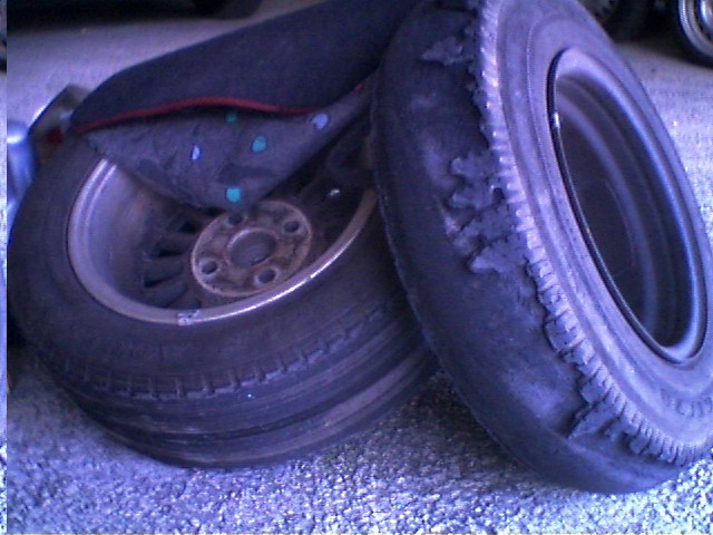

10-20-2005, 10:15 PM
Mobikrog SLOWenia, sunday 16.10.2005.
What have you done to the tyres? Huh Huh
10-20-2005, 10:31 PM
Hashiriya Wrote:What have you done to the tyres? Huh Huh
Burn out (down)?Smile
What is the size?
"..el camino's aren't supposed to make sense, craziness is what makes the world go around." - Car & Driver, 1984
10-20-2005, 11:28 PM
3.0 bar and drift happend to the tires, not burnout
What is the size?
Burnout isn't fun, tires are killed in real action :wink:

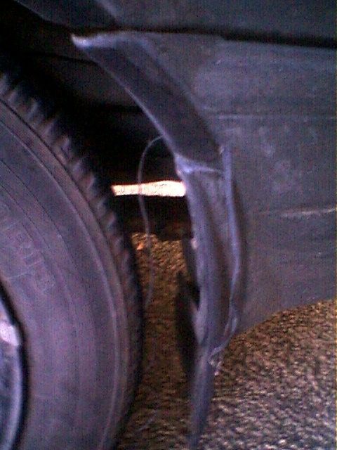

Suspension completed means;
REAR: yellow Koni's set on 3/4 hardness + 8kg/mm springs + 25mm wheel spacers (tires; 175/70 R13, 185/60 R14, 195/60 R14, 195/50 R15....depends Wink
FRONT: t3 camber plates (-2.6*) + coil over kit with 8kg/mm springs + ae92 koni's set on 3/4 hardness + rca + 20mm wheel spacers + 195/50 R15 T1R tires
week before, I tested car without RCA... it wasn't so fun, because I spinning often. Front was bumpy, specially when you if in drift passed over dent, one wheel looses grip, and you spin easy... With RCA, another world... Handling in drift improved amazing, no more spin out's when passing dent's, bumps...
Summary: car is complete prepared for dry drift, only what I need is sponsor for tires Wink
