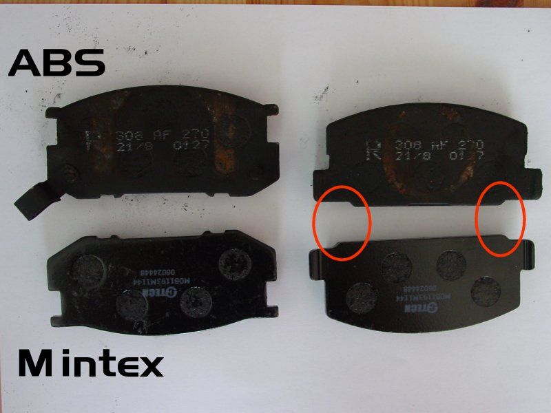

A small note of caution for installing, the inner pads have a ledge on the top that is slightly larger then the stock pads, I remember Zax mentioning this before but I'm not sure if this is the same for all hachi's. I had to sand about 1mm off this ledge to make them fit fine. I'll take some pictures later on and I'll ask Mintex about this aswell and see whats up with this.
Comparing them to my old pads thats all thats different in form, there is a slightly larger area of friction material allthough the pads themselves are slightly thinner then my ABS pads (thats an actual brand here yeah Smile ). I'll take pictures of the pads together.

Also attached a picture to show the difference in the Mintex (bottom) and ABS (top) pads asfar as size and form goes (backplate), on the left are the outer pads, their fine, on the right are the inner pads. You can see the ledge that smaller on the ABS pads then on the Mintex pads and for me atleast, that gave a small headache when installing them.
Would like some comments from you guys on this, especially people already using mintex pads, did you encounter the same thing?
If so I'll communicate this information to Mintex on Monday. I doubt they will take any sort of immediate action as they probably have to work through their stock, but hopefully they can adjust the pads for new batches they make.
Note, the ledge on the ABS pads is much smaller then needs be, you only need to sand a small amount off the Mintex to make them fit, also I recommend first trying them as they are, I really would like to find out if there is any difference in brackets on different AE86 models.

Thanks for that, we got the 1193-1144 right now, so you had to grind them slightly as well?
1198-1144, I'll ask about those then. They will probably cost more then the 1320's though...
02-24-2007, 03:04 PM
Mintex brake pads installation
Jep,
I have also had to grind the fronts on both the red AE, and also on this one,
It will fit without, but when they wear a bit, they will only press against the disc with half the pad,and therefore destrying the pads,

OKay tonight I suddenly had the oppertunity to finish what I started, I wasnt happy with the soft pedal feel and the brakes squeeled, but I did the install of the pads in a hurry cause I did it on our local parking lot and the weather was turning pad so I didn't sand the pads to well and didn't install the squeel plates.
Tonight we suddenly had to do some work on Oldskulls car so I found some time to jack up my car, take the inner pads out, sand that edge down properly, put the squeel plates back, bled the brakes, and voila, everything installed proper.
The way back home was amazing, weather still stuck so its wet out there, but pedal feel was rock hard now, brake responce instant, and I kept locking my brakes up due to this nastly weather.
I can't wait to try these things in the dry Big Grin
Anyways, motto of the story is, unfortunately some small adjustment is needed to the pads for them to be installed properly, but once installed, whow!
