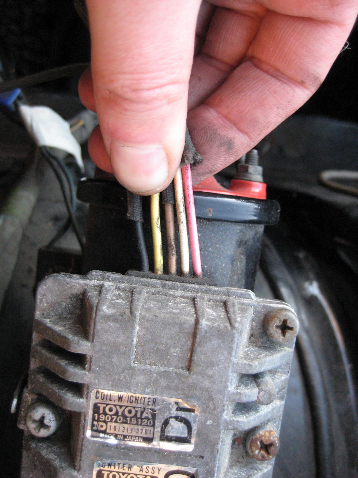

I need some advise on how to control my iginition using MSI v3.0 and standard igniter/distributor.
Let me say that electronics are NOT some thing I know a lot about so PLEASE do not use any slang or abreviations when answering - thanks.
If some one could draw a wiring diagram I would be thrilled Big Grin
- Niels

Hi
No not the same. They (gon) used a VAST (AFM) igniter - mine is a ESA (MAP).
I have RPM signal to the MS from the VR sensor to "tach" input (using the VR-sensor circuit). NOT using the Igniter to condition the signal!
What I need is to know is which wire (color) is IGT, IGF and NE?
- Thanks, Niels

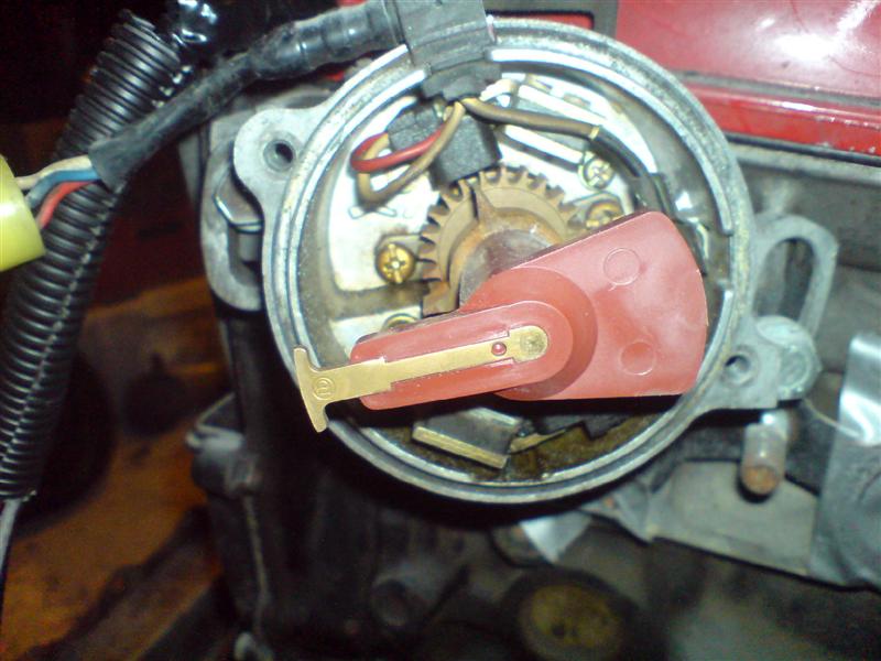

This is how I did it on the 4age for my KP61 I'm building right now running MS1. Have a bit to go before attempting startup yet, but can not see any reason why it should not work. MS should read it as a 12-1 crank VR setup.
Stock dizzy:
[img name=]http://www.aeu86.org/files/ds/dsc00657_medium_102.jpg[/img]
Dismantled it:
[img name=]http://www.aeu86.org/files/ds/dsc00659_medium_545.jpg[/img]
Ground down two opposite tooths (dont recall which ones, but can check if needed):
[img name=]http://www.aeu86.org/files/ds/dsc00660_medium_661.jpg[/img]
And remounted. Also removed second VR sensor to minimize chance for crosstalk, as it should not be needed for MS and batchfire.
[img name=]http://www.aeu86.org/files/ds/dsc00661_medium_108.jpg[/img]
