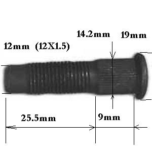

jamiemirror post the OEM stud spec here.
[Image: AEU86 AE86 - Longer studs]
