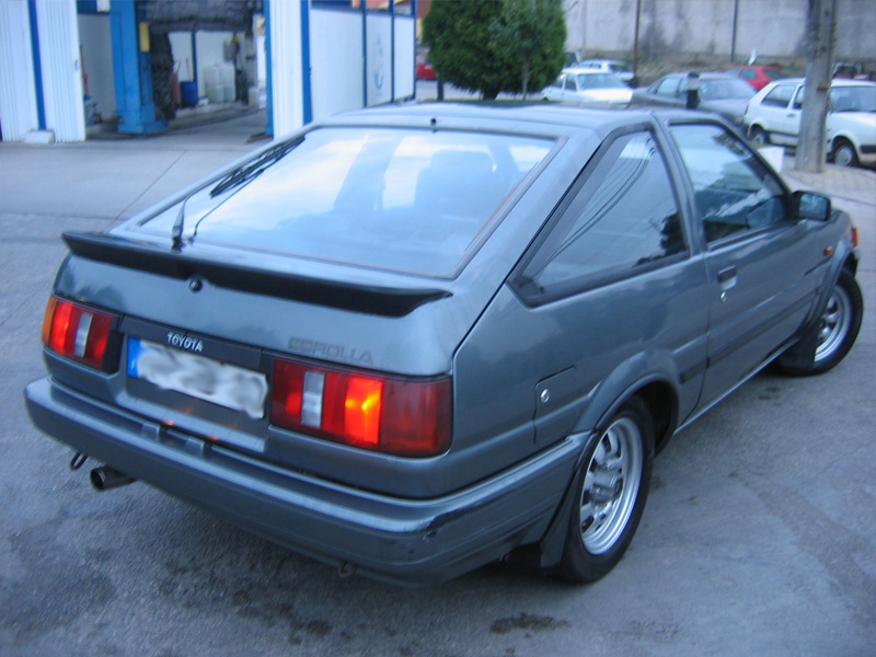

Just showin new pics. Tomorrow will be the Portuguese AE86 meet, so i went clean up the car, changed wipers and stuff. After taking this pics, i realized that i have no "low" lights. Gotta look what is the problem... ![]() Cump´s Filipe Oliveira |
