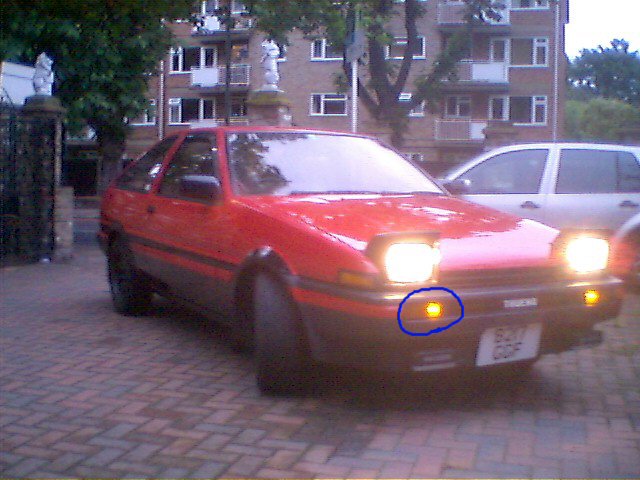

Hi guys,
In the hope that someone can help, my low lights do not seem to be working, along with my front fog lights and the outer tail lights. (The outer tail lights work when the brake pedal is pressed but not when the lights are on).
I've checked the fuses, and they all seem to be good. Is there one fuse that I should double check? (I checked them at night Undecided )
The headlights, brake lights and inner tail lights still work.
Anyone have any ideas?

mine all worked before, so its definately a problem that happened just yesterday. My car is JDM so all 4 lights light up at the back.
Fog lights are the stock toyota ones, and they were connected also.
Will update u guys on my findings later today

Fixed!
It was because I had my gauge cluster surround off and the parking light button wasn't plugged in.
Everything is back to normal now...gg

Not sure if its because my car is a trueno or because its JDM, but I have a button I can use if I park my car in a dark place. It lights up the outer rear lights and my front low lights.
Its on the gauge surround, a button with a "P" on it...
