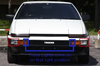

[Image: AEU86 AE86 - Lights - How to turn these on]
It may be a stupid question. How are these turned on?

ok just been out to check.
All other lights are working fine. there is a connector that is 4 wires for sidelights, indicators and these lights.
The plug.
[code:1:d8468c0bcf]
[GND][12v]
[???][12v] Ignore this, this is wrong...
^ That connection goes to those lights. it doesn't get 12v, it constantly has 0.05v
[/code:1:d8468c0bcf]
Have a look at the attached pic. the inside lights seem to act as you said that the outside lights should...
Any ideas.

I've turned all combinations of lights on and they don't light up...
But i am missing a switch from the car which i have now discovered is the fog light switch... i shorted the plug and the lights still don't come on... also tested continuity from that connector where the switch should be and the plug and there is nothing...
if some one could confirm they are fog lights i'll rewire it...

It sounds more like it's wired like a zenki Trueno to me... Undecided
Maybe some Initial D fan wanted it to act like a Zenki? Blush
Anyway, this is how it should operate:
So everything works normally on your car, except that the white part doesn't light up when engaging the turn signal.
