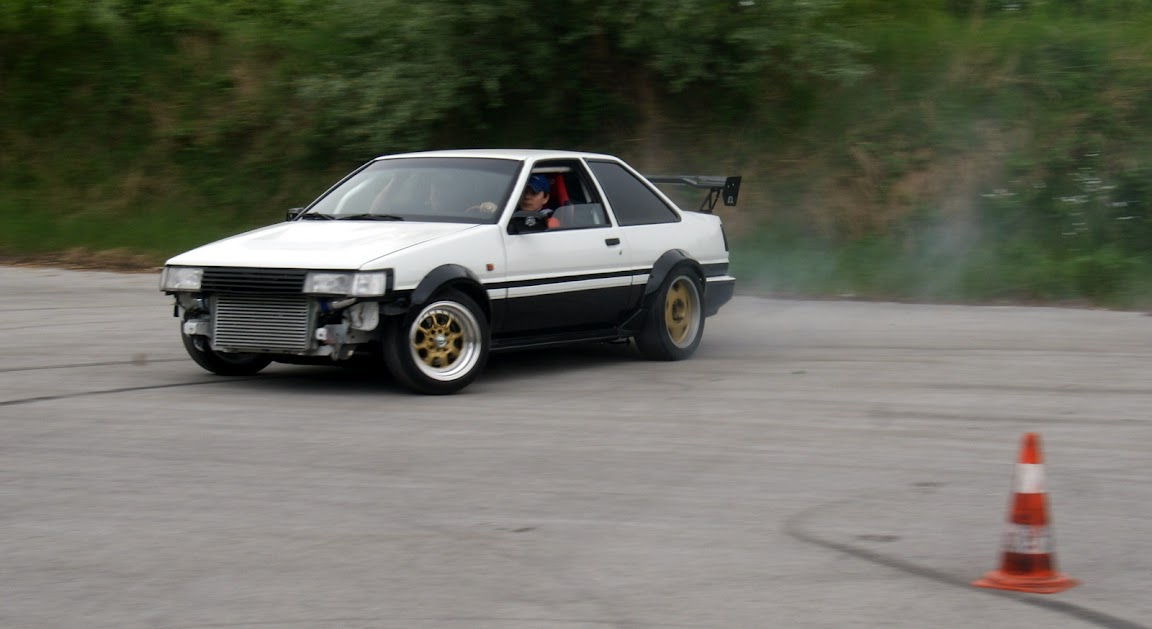

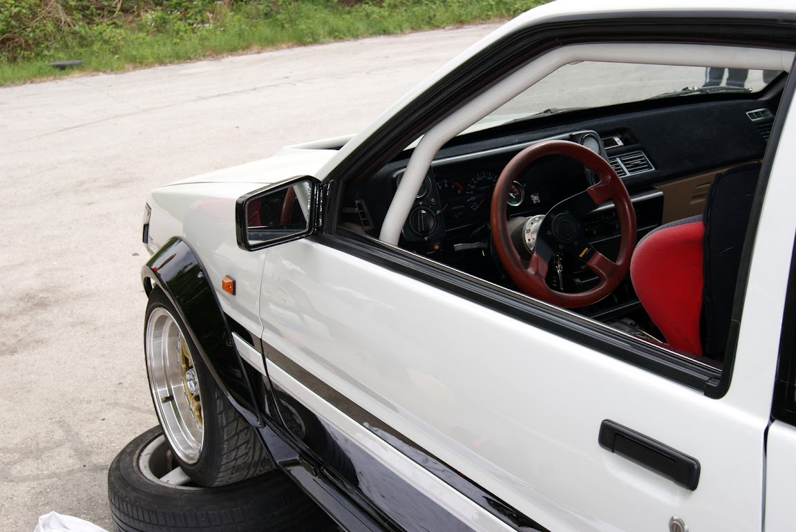

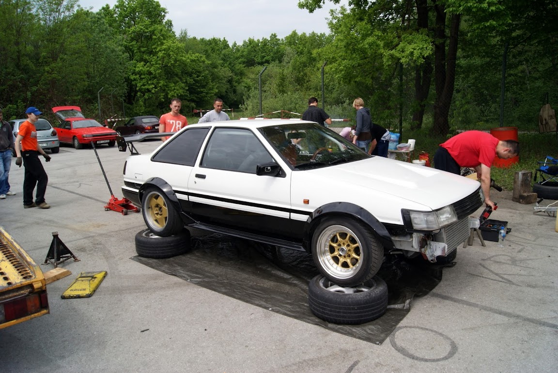

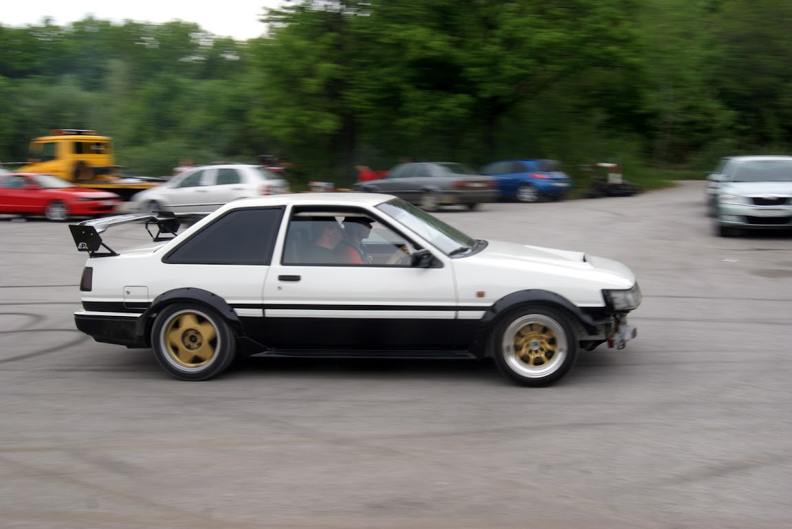

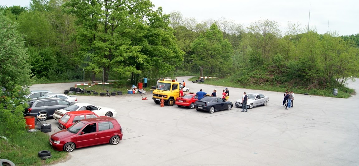

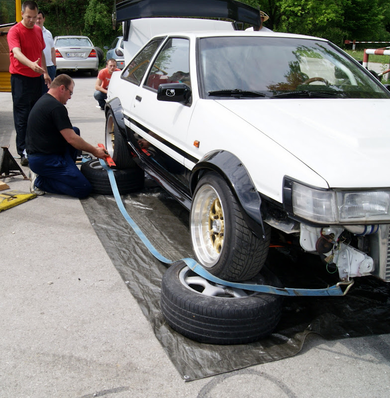

Is alive. First test drive on a small poligon.
I love the power delivery and how rear end squats under the acceleration.
We fixed some bugs (fan pushing air out, one boost leak...)
Some pics

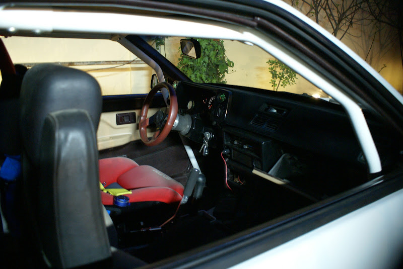

Latest specs
Toyota Corolla AE86
Engine
Engine SR20DET 2.0 liter DOHC Turbocharged - Stage 3
Horsepower 319 hp @ 5700 rpm
Torque 420 Nm @ 4500 rpm
Boost 1.2 bar
ECU - Nissan + Nistune
Nismo 555ccm fuel injectors
Walbro 255 fuel pump
Garrett GT2860RS .64 aka. Disco potato
Autobahn manifold
Blow off Valve Type-china
Front Mount Inter Cooler Kit
Lastovčić Extreme Power 70mm exhaust
Manual boost controler - 3barr racing
A'pexi Power Intake Air Filter
300ZX Z32 air flow sensor
Z32 fuel filter
Spec stage 3 clutch kit
electric fan
custom engine mounts
Interieur
Heigo 6 point roll cage
flocked dashboard
Modified hidro handbrake

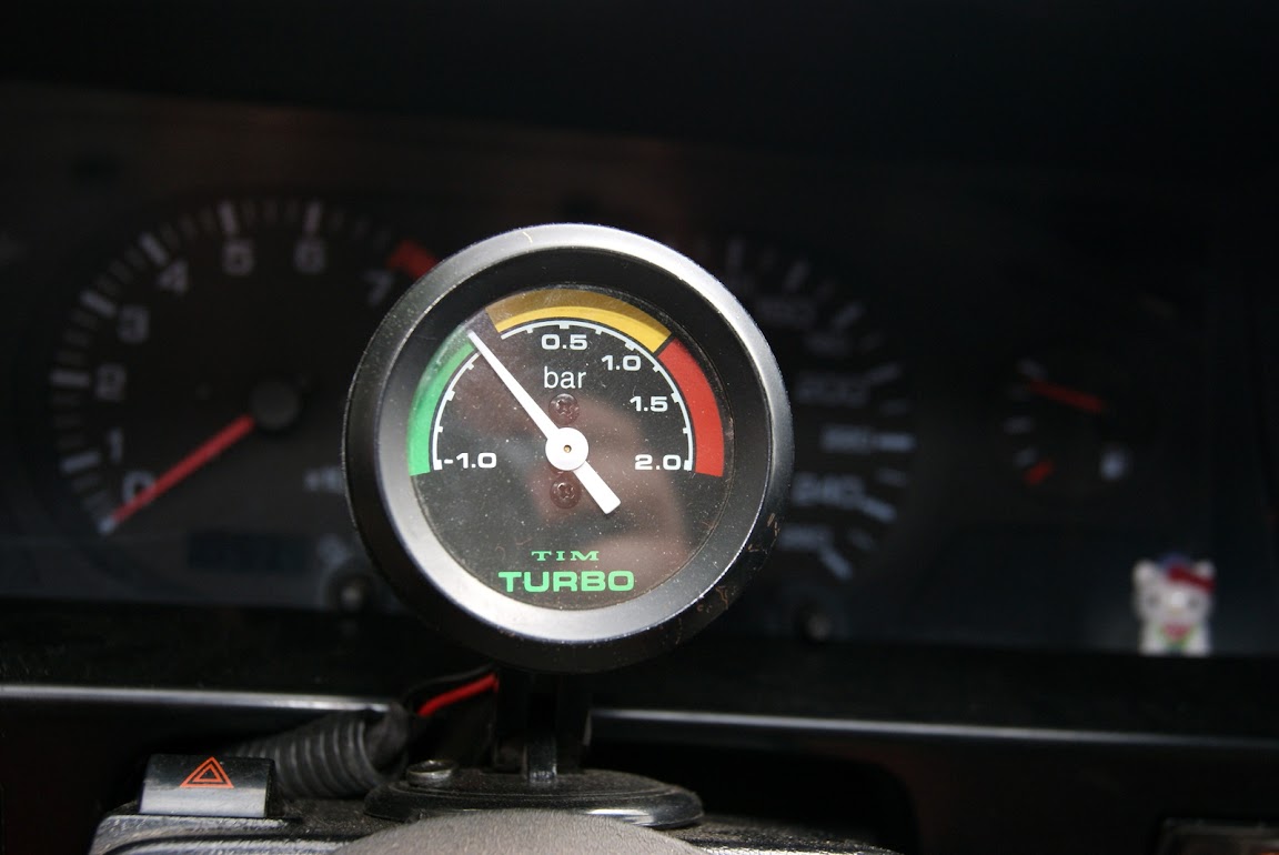

TIM boost gauge
VDO oil pressure gauge
VDO oil temp gauge
Sparco Evo bucket seat
Sparco harnesses
Sparco steering wheel
Suspension
Driftworks CS2 coilovers 8/6 kgf/mm
Driftworks Lower Arm Front and Rear
Custom tension rod
Custom Tie rod + tie rod end
custom designed steering knuckles
KAAZ S14 2-way metal LSD
3.916 final gear
S14 rear swaybar
AE86 front swaybar
alloy subframe locking kit
S13 front brakes
S13 rear disc + drum brakes
Conversion from 5 bolt to 4 x 114,4
Sportmax XXR 15x8 ET0 wheels
Borbet Type A 16 x 7,5 wheels x 4
Borbet Type A 16 x 9 wheels x 2
Kerscher Carmona 16 x 9 wheels x 4
Puno raznih 15 i 16" felgi
Exterieur
Zenki front bumper with lip spoiler
Kouki side step
CBY overfenders
Custom made hood vent
Huge APR Carbon 3D wing
Gear ratios with 7200rpm redline and 205/50-R16 tires
1st gear 60 kmph
2nd gear 105 kmph
3rd gear 152 kmph
4th gear 199 kmph
5th gear 238 kmph
Final drive ratio 3,916

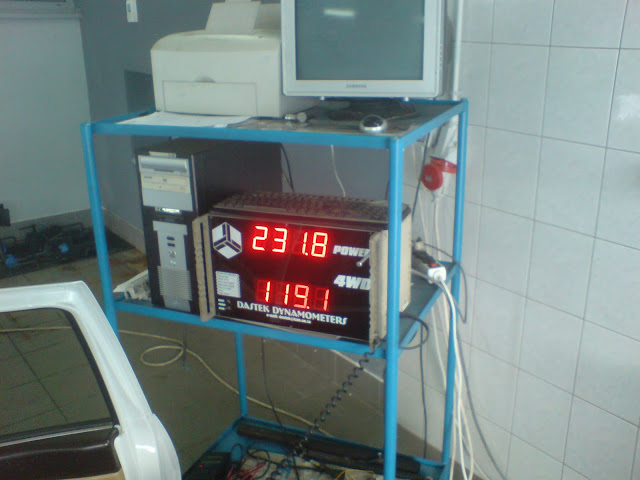

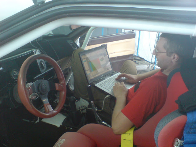

Car went on dyno today to check the fueling.
SR20DET, 1bar of boost, GT2860RS and other stage 3 supporting mods.
[Image: AEU86 AE86 - Levin Coupe from Croatia - ...6 with IRS]
Started with this
Finished with this
Full boost at around 3000rpm, holds till red line.
301 wheel HP at 6300 rpm, 95RON.
Does this numbers justify the wing?
