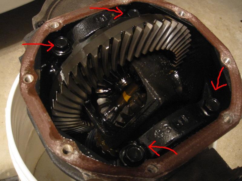

AE86 LSD:
[Image: AEU86 AE86 - L.S.D]
S13 open diff:
Open diff of the AE86 looks not much different than the S13.
As you can see the LSD is a closed housing (contains the clutch assembly) while the open diff is much simpler in design (open) with four connected gears.
The axle itself doesn't say anything: Djexor's car is an AE86 with the 6.7 inch differential, however his car does have an open diff from the factory.
