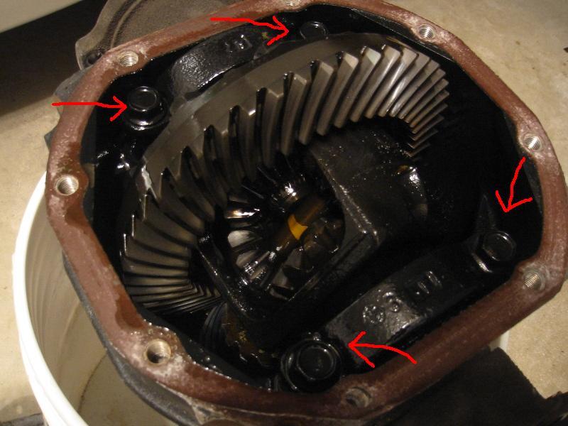

AE86 LSD:
![]() S13 open diff: ![]() Open diff of the AE86 looks not much different than the S13. As you can see the LSD is a closed housing (contains the clutch assembly) while the open diff is much simpler in design (open) with four connected gears. The axle itself doesn't say anything: Djexor's car is an AE86 with the 6.7 inch differential, however his car does have an open diff from the factory. 1983 - AE86 Sprinter Trueno - import project 2013 - Honda Civic sport - daily driver 2004 - AEU86 dot ORG - daily domain Support our forum, buy from the AEU86 shop:
