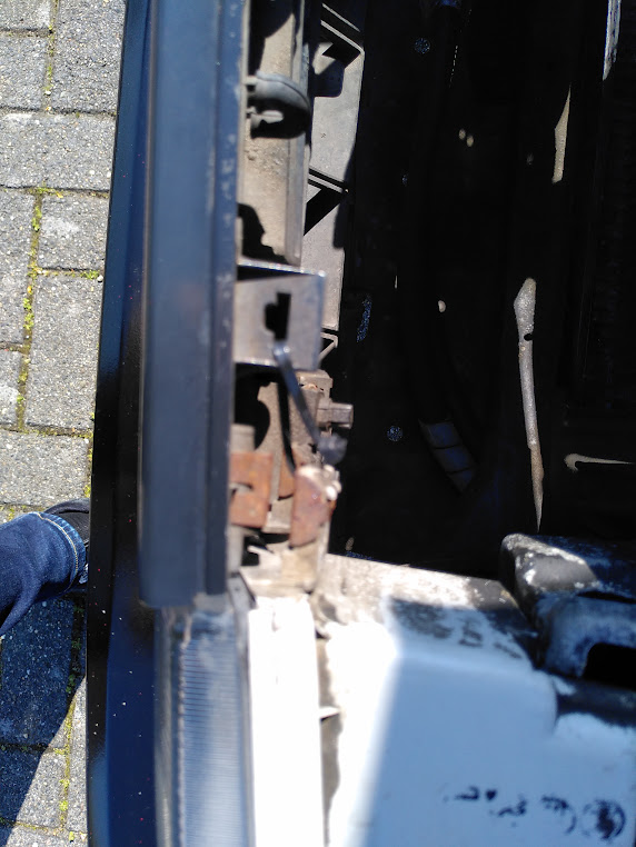

I did it recently, Banpei shared my car above.
I bought a new grill from flos (assuming they are identical with the OEM ones). The middle bottom mounting point worked for me, the top one i took off. Then used 2 zipties on the sides to secure it. |

if you have fog lights, you have to dremel out a bit of the material from all of the slots on the engine side of the zenki grill (except the lower one)
it will fit nice, just use the original grill tab points and zip ties https://www.instagram.com/p/CnzTV8zI2NR/?hl=es |
