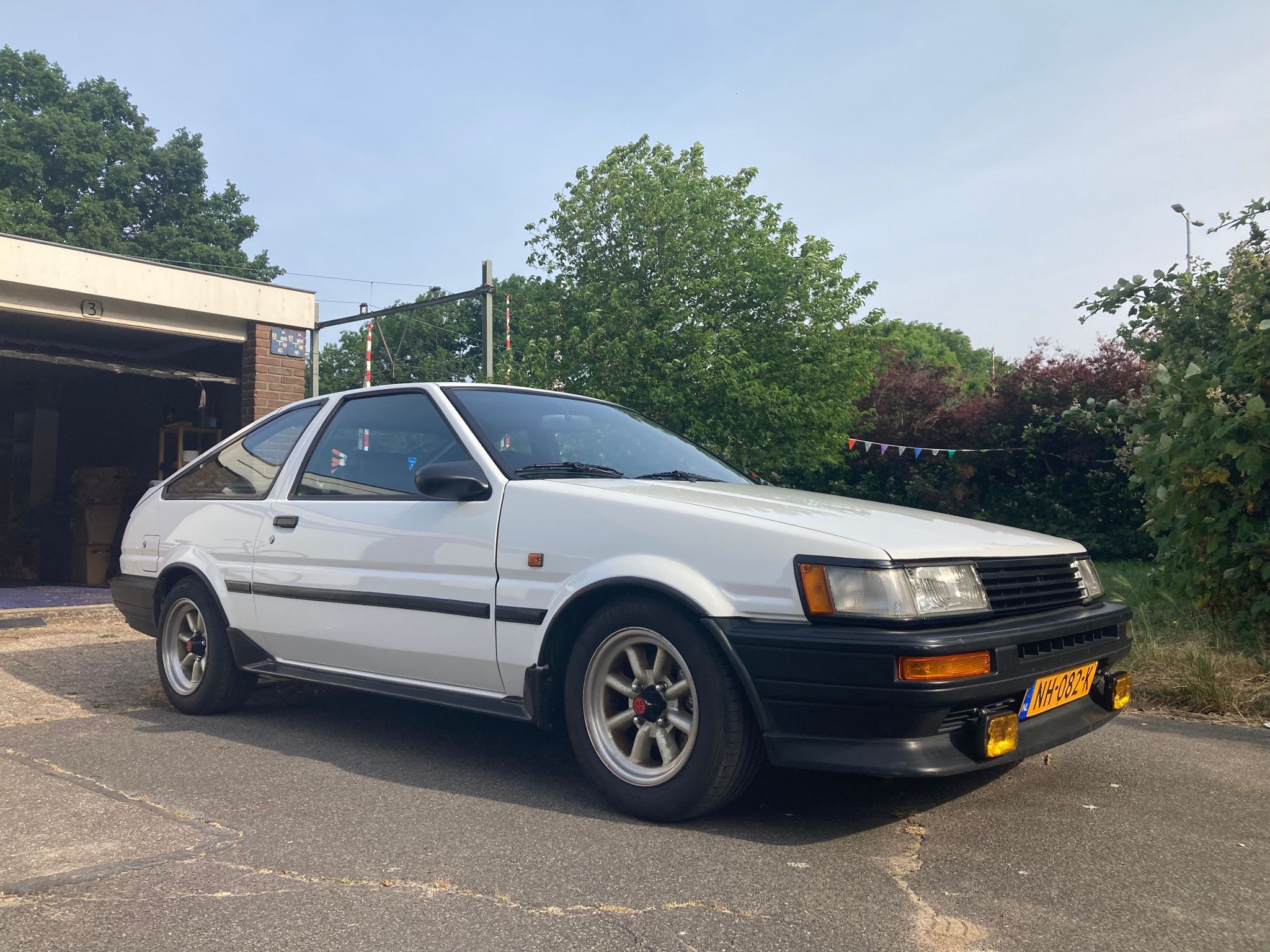

However, r.ave did the same thing and for him, it worked:
[Image: AEU86 AE86 - Kouki to Zenki Levin grill conversion?]
So maybe he can shed light on his magic trick. Wink

I did it recently, Banpei shared my car above.
I bought a new grill from flos (assuming they are identical with the OEM ones).
The middle bottom mounting point worked for me, the top one i took off.
Then used 2 zipties on the sides to secure it.

@r.ave yours looks perfect
