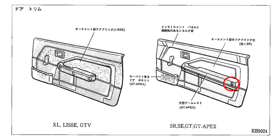

So in the process of removing my door mirrors - because they are electric, I need to remove the door card.
I have everything loosened - except the 3rd clip for the armrest - the square plug closest to the end of the door ? which looks like it should pop off and reveal a screw, doesn't seem to. I don't want to force it further, so does anyone have a tip on how to remove the armrest ?

I think you have the one on the right:
[Image: AEU86 AE86 - Kouki door card removal - help :)]
I think you're referring to the one at the end of the armrest where I put a red circle around.

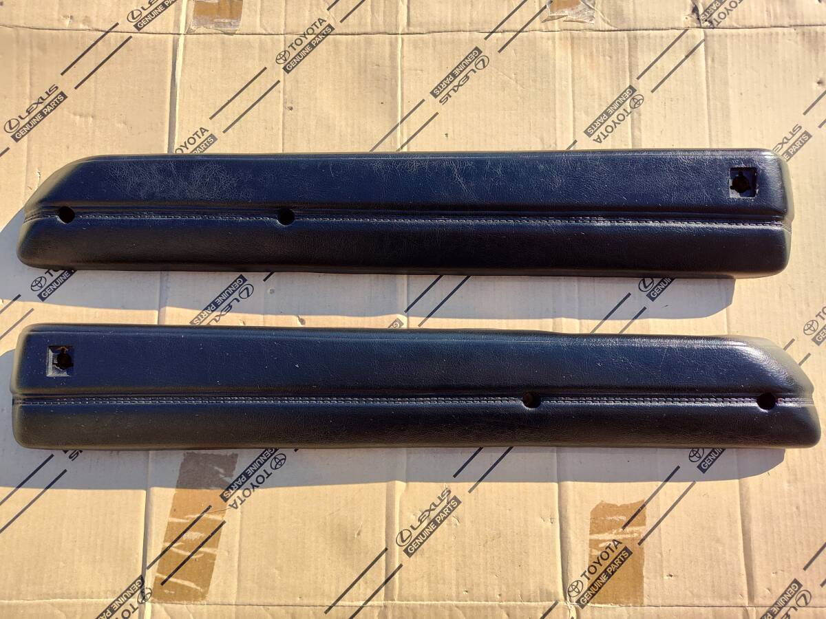

I found this image of the armrest on an auction:
It's the same as on the zenki, there should be a small plug that you can remove to reveal the bolt that retains it.

03-08-2026, 11:51 AM
thanks Banpei, yes I have the one on the right - just needed the vote of confidence I'm not snapping a piece of plastic !
