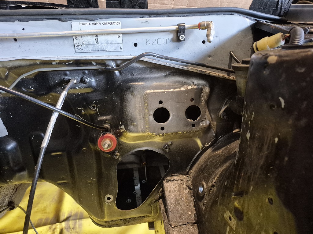

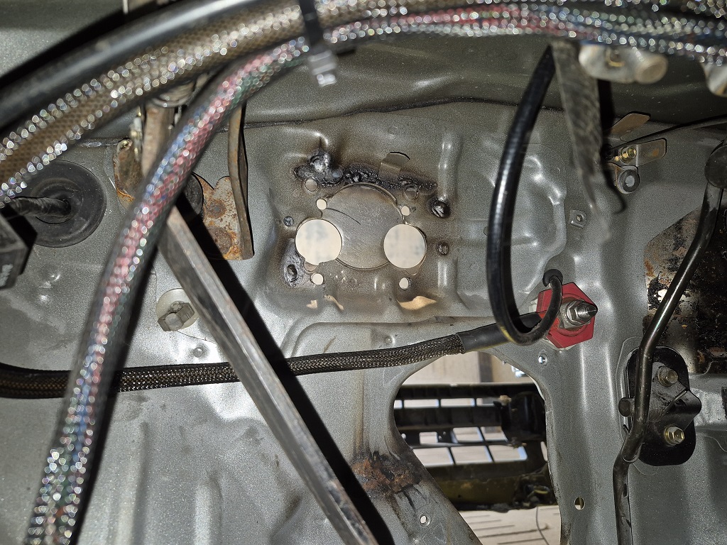

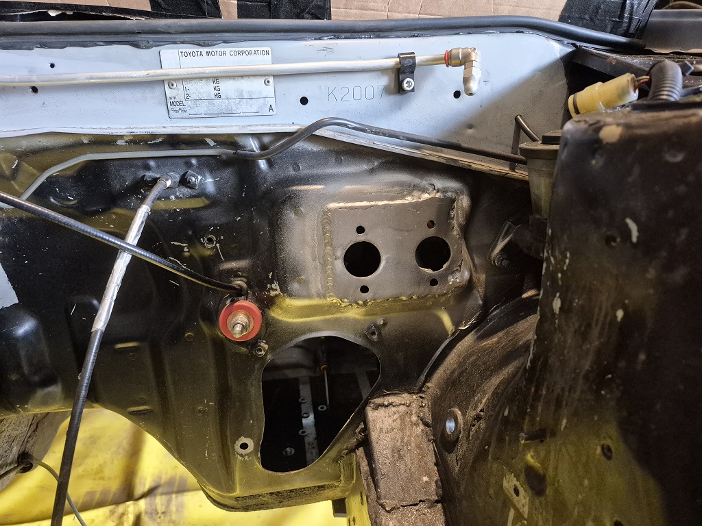

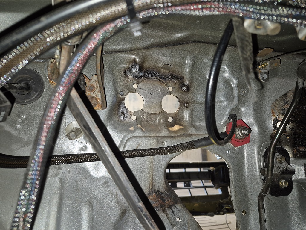

Made some progress creating the twin brake master cylinder for the grey car.
Two options to make this in the homologation papers ![]() I decided to keep the cilinders in the engine compartment. The green car has a similar setup, so I could copy some dimensions from that car. Removed all the old bits from the car to have some room to build something new. I've welded a plate on the bulkhead with the correct holes for the AP cilinders and to add some stiffness (the bulkhead flexes quite a bit when braking) ![]() As you can see it's in practically the same position as the original. It fits in the "box" in the bulkhead which also helps to prevent flexing. ![]() I've made a box that screws to the bulkhead using the bolt holes of the AP cilinders. Its welded to a cut up original bracket of the brake pedal which contains the brake light switch and the top mounting hole. ![]() The tube that holds the balancebar will be welded directly in the original brake pedal, but I forgot to order that . Then the whole assembly should work and fit in the same position as original ![]() The top one is the full original assembly, bottom one the replacement (+ balance bar and the reservoirs) |
| all wheel drive 3SGTE corolla | qwoson | 3 | 6,398 |
03-23-2008 01:50 PM Last Post: Gtsi-R |
)![AEU86 AE86 - Koen's 86 - every drive a new issue [Image: AEU86 AE86 - Koen's 86 - every drive a new issue]](https://www.aeu86.org/forum/Attachment-17862.jpg)
Next step; make a twin brake master-cilinder setup because I didn't like the feel of the bigger single master with booster in the 5km I drove ...
