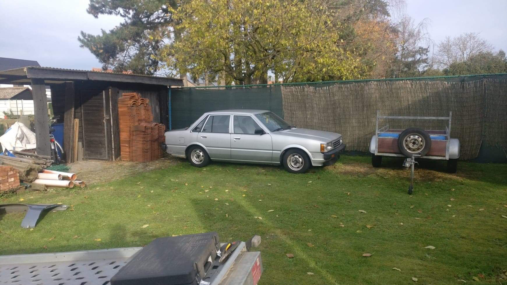

Third time's a charm, right? So I've bought this car in 2014 and sold it, then bought it again in 19/20 and sold it in 21' again, just to buy it again this year.... And keeping it this time DodgyDodgy
It's a 85' A35 LC. So 4K-C, K50 etc etc..
Slowly working on it to make it look good again and mechanically in order. Got all the parts laying here to convert the front struts to coilovers wich will be done soon.
Future plans are hopefully swap in a 4AGE 16V and AE86 running gear. Do some body repairs in the rear as usual and drive it Smile
Next orders will be an adjustable panhard rod after lowering, along with some RCA's and a new radiator.
(Pic's coming, i'm having some difficulties Big Grin)
