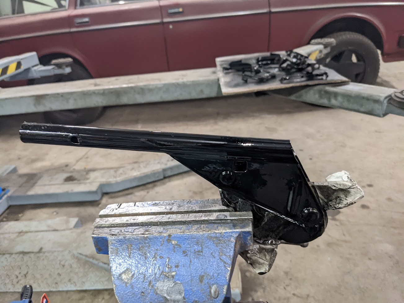

Gave the parking brake some 2k black and emptied the rest on an assortment of brackets again.
[Image: AEU86 AE86 - Ivan's coupe: bodywork is done]

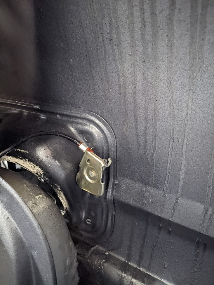

Had a go at fitting the remotely operated fuel filler lid.
Had to drill off the old lock tab and drill a new hole for the popper:
Didnt get the tab off quite cleanly and I didnt want to weld any more at this stage (risk setting paint on fire). So I drilled the rest of the spotweld out, painted it and put a rubber plug in the hole. That will do.
