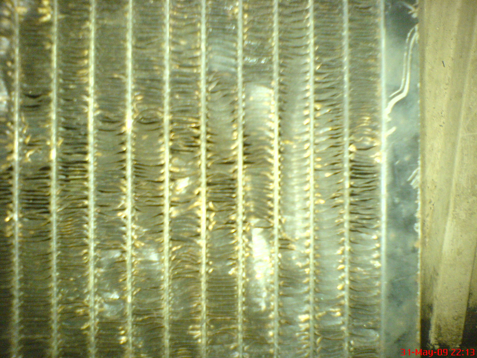

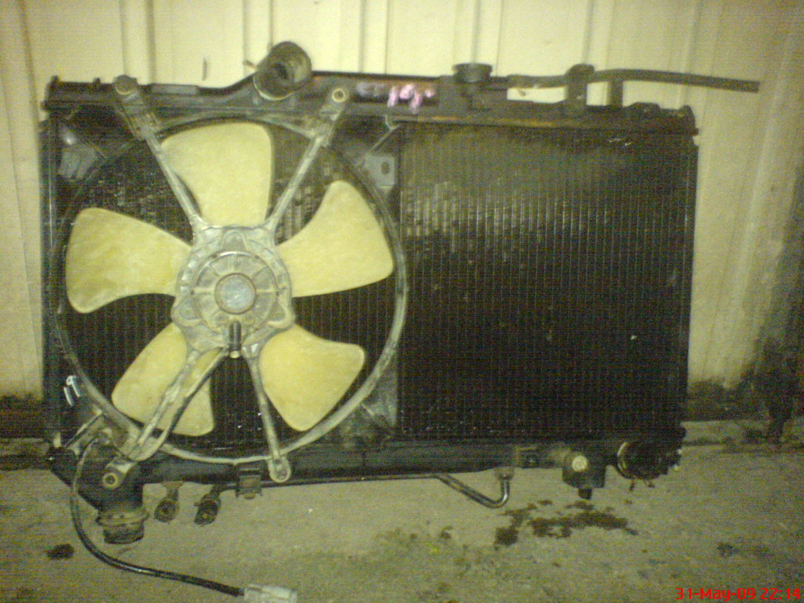

hey guys I bought a radiator for the conversion. Not sure whether this will workout but going to try out.
Its a late model Corolla rad with a single electrical fan but can fit another one which I'm planning to.
Got it for 65USD.
It's longer than the stock radiator so I guess one side of the radiator has to be hinged to a fabricated mount. and the top inlet is far towards the right so I'm not sure hosing can do the job.
what do you guy think? Can a set of silicon hosing could do the trick to the change of water inlet???
Sorry for the low quality images..
Thanks in advance, Heshan.

There will be a lot of work involed in mounting that radiator, to mount it central in the engine bay you will most likely have to remove you battery holder, an easier option is to mount an aftermarket fan onto your factory radiator, they are usually more powerfull and are a compact design compared to factory fans.
