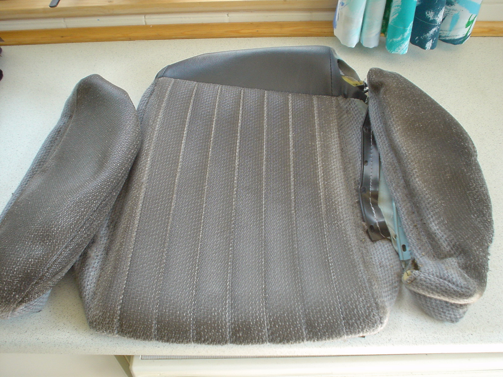

Just rip off the seats skin and throw it in the washer, it cant be done easier (or cheaper):

Knudsen Wrote:Just rip off the seats skin and throw it in the washer, it cant be done easier (or cheaper): Knudsen, how could you dismantle the seat like that?! Do you have some more pics? I DO believe this is the best way, but I dont believe I will be able to put the seat together .

The "skin" is kept together with alot of small metalrings. Those rings can be bent out, so the "skin" can be peeled of. Pretty easy.
You can either use the rings again, or like i did, replace them with zip-ties. I havent got any pictures of the proces. Youtube Myspace and I´ll Google your Yahoo |

Knudsen Wrote:The "skin" is kept together with alot of small metalrings. Those rings can be bent out, so the "skin" can be peeled of. Pretty easy. I also tried it exactly the same way, replacing the rings with zipties: I washed the seat-skin two times but they turned out to be still dirtier than my current seats. BTW: this pic was only after vacum cleaning one of them. ![]() And since getting all rings loose and replacing them with zipties takes a long time to do I think I'd better go for the DJexor way. ![]() It's amazing Mike! 1983 - AE86 Sprinter Trueno - import project 2013 - Honda Civic sport - daily driver 2004 - AEU86 dot ORG - daily domain Support our forum, buy from the AEU86 shop:

And since getting all rings loose and replacing them with zipties takes a long time to do I think I'd better go for the DJexor way. :) [/quote] Hmm... i dont think i want to know how slow you work Banpei :wink: It took me less than 10 minutes to dismantle both the seats, 4 beers to wait for the washingmachine to get done and app. 10 minutes a seat to put back together again. Thats about half an hours work and the car smells like new afterwards, and look far better than if you rub the dirt even more into the seat Youtube Myspace and I´ll Google your Yahoo |

Quote:It took me less than 10 minutes to dismantle both the seats, 4 beers to wait for the washingmachine to get done and app. 10 minutes a seat to put back together again. See it from the bright side If I had drink beer during the washing project I would have been drunk! oke I finished my second seat! It's still a bit wet, but see the difference compare to the previous pic 5/2018 BMW F22 Coupe 1/1985 Toyota AE86 Levin Coupe |
