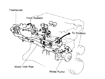

After checked the 4AGE manual, I found the pipe I mean. It is Water Outlet and By-Pass Pipe i think Smile

R these the two hoses under the throttle body?
02-12-2006, 01:08 AM
Idle speed problem
Mux213: Yeah, I was so happy. It could be happened when the car 7 years never started and also the dirt come from radiator.
alimonos: Yes those 2 hoses what I mean
02-12-2006, 01:53 AM
Idle speed problem
Congratulations! Thumbs up!
But I still not sure which pipe it is? Is it the upper or the lower? (or neither?)
