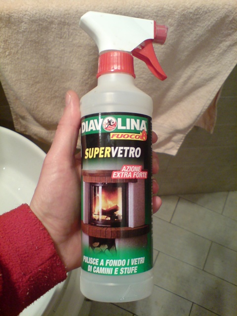

12-26-2010, 11:34 PM
Post: #45
Idle problems
Hachi Wrote:thx... i found it on toydiy...
as for the oven cleaner... lol
i thought its refering to some special oven for cleaning... like some injector cleaner Big Grin
as for liquid oven cleaner, i know just the thing to buy...
I've tried to clean it with the brake cleaner first but with no results.
It's not exactly the oven cleaner but for cleaning fireplaces glass screen. Basically it's the same thing. It looks like this:
Fun is not the straight line!

12-27-2010, 10:03 AM
Post: #47
Idle problems
Hachi Wrote:yyy i get it now...
i just understand it differently...
any other tip? u boild it to clean it better?
I boiled it after cleaning just to check it's operation. The black cone should come up and close the bypass hole. Some small amount of air will still pass.
There are no special tips, you just have to:
1) Remove throttle
2) Take off AAV (5 small screws under throttle body)
3) Clean it with solvent, then with water. Repeat a few times. It’s good to change water temperature to make some movements inside during cleaning. You'll se all dirt and black water coming out each time. Repeat until it's clean.
4) Dry it and put just a little WD40 inside.
5) Put all back together. Probably you will need to change gasket + small o-ring. I bought new rubber o-ring and made gasket from special paper.
6) Run the engine and bleed the cooling system from air bubbles.
...and I hope you will get at least 200-300 rpm lower idle.
