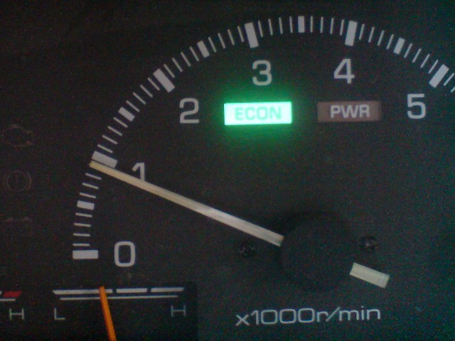

So, after cleaning AAV and bleeding cooling system of air bubbles, I got 900 rpm warm idle Hurray!
Not bed as there is -1 C outside. Of course, it could be better but as I don't have this adjusting tool 900 rpm is better then 1200-1300 as before.
