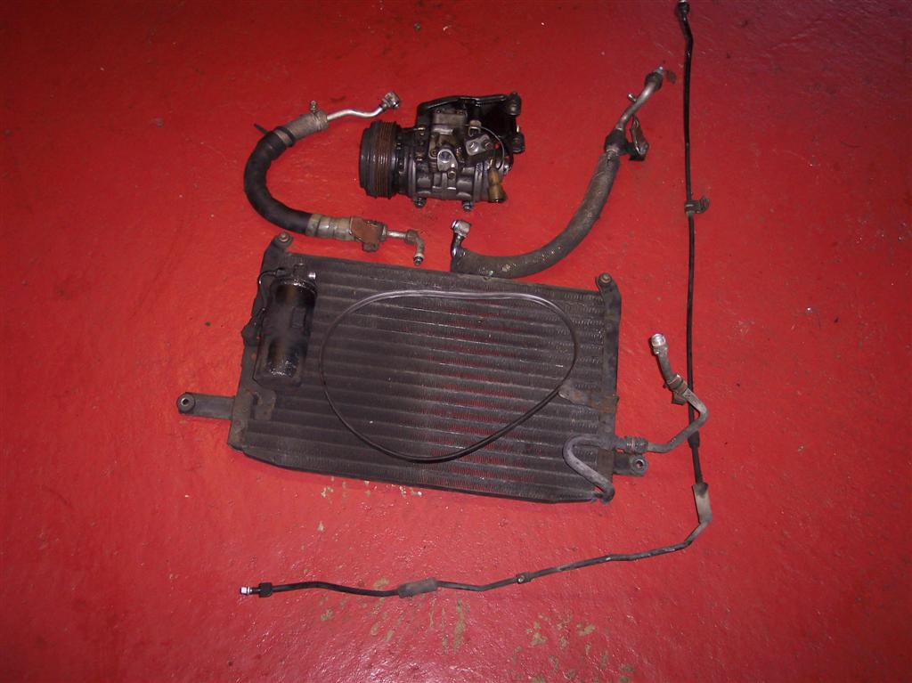

Bit more work today - nothing too serious though as I am still tired from a busy week.
I've now removed the aircon from the engine bay (there is still all the stuff behind the dashboard to come out yet though). Its all in really good condition (if a little dirty) and is for sale along with the aircon panel from the centre console if anyone wants it.
Also removed the viscous fan from the end of the water pump. This is not going back on the car as I hope to run an electric fan system when the car goes back together.

[Image: AEU86 AE86 - Ian.G's Track/Drift Levin.]
