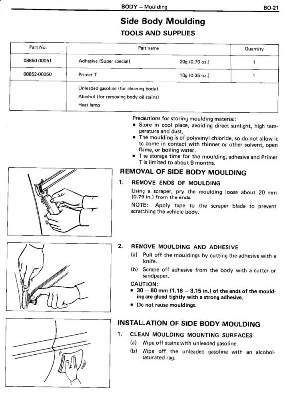

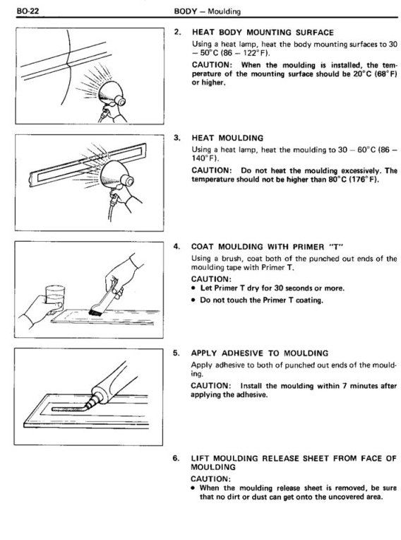

Wave
[Image: AEU86 AE86 - How to remove side mouldings?]
