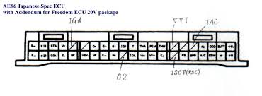

Some valid points about the idle valve and my ecu can control the 20v
idle valve if I can find the output pin from the ecu.
There is also a chance that it can control the vvc too.
01-09-2013, 03:05 PM
The dark side
http://t2.gstatic.com/images?q=tbn:ANd9G...n41t-klbJ1
The original picture was available on club4ag, but the site seems to be down Sad
01-09-2013, 05:22 PM
The dark side
aaah....
Perfecto Thumbs up!
Thanks
