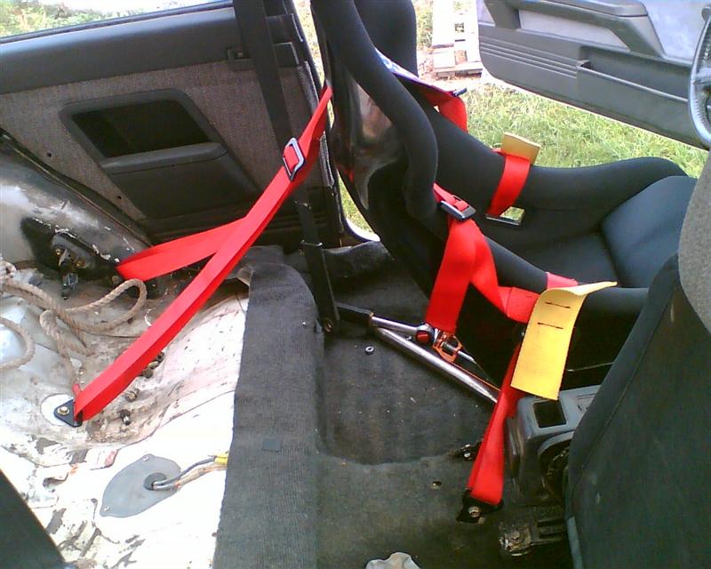

Under rear seat you have bolts for stock rear seat harness...
Even better is rear strut bar, if you have one.
Pic that better explaines...

meshin Wrote:Under rear seat you have bolts for stock rear seat harness...
strut bar is ideal... This is too much harnes angle Mesh... You are risking with this... check Appendix J FIA... you will see why... Althou this is better than the ones I saw on some cars... Wink

2 mrgud: this is the best I can do in my car for now. Waiting rear strut bar, then it would be on it.
2 TRUENO><ONEURT: my friend screwed the harness like this on picture, but put something like holder (screwed in) little higher so the harness was going right between the crack in rear seats (between horizontal and vertical joint of the rear seat, if you know what I mean).
