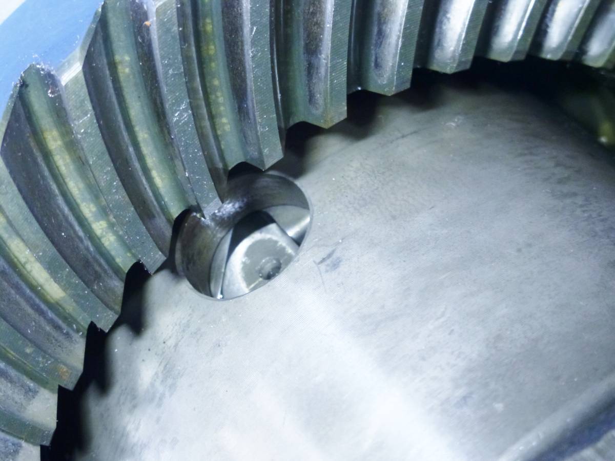

Hello,
I might buy a secondhand diff but need to know if it's a 1 or 1.5way. Can someone judge on the picture? I hope to get a better picture soon...Thanks
Also, I think 2 way is too aggressive at throttle release for rallying (gravel, wet...). Any rallydrivers with experience about the best option? Thanks a lot Wink

Looks like a 1 way to me. What brand is it. Some diffs can be disassembled and rotated to change the behaviour.

Agree with Bean.. a 1,5 way or 2 way would never have a flat side on the cam.
