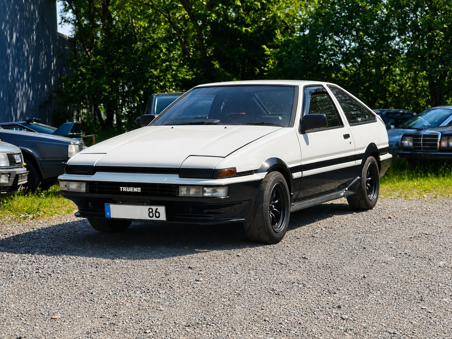

Is that Stephan's AE86?

Yes it is!
And i can you show a few more pictures Huh
