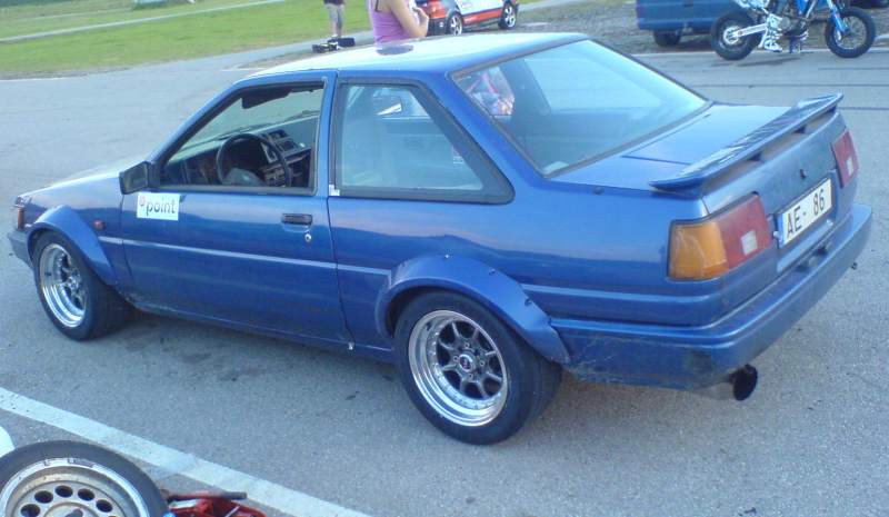

We recieved rims and tires Smile and installed few other performance parts: lightweight flywheel, Martelius header and exhaust system, lightweight battery. These mods reduced cars weight by 24 kg.
[img name=]http://www.aeu86.org/files/b3/b3_199.jpg[/img]

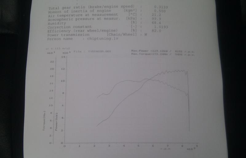

gt99 Wrote:So today we measured engines condition on chassis dynamometer. Results: max power 115 bhp, and max torque 145 Nm on flywheel (calculated with 18% loss).
After two years we visited chassis dynamometer again.
119kW@8100rpm (160hp)
173Nm@5400rpm
