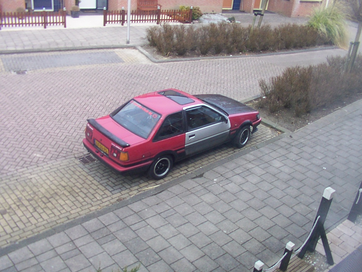

Fitted the 14"stuff today...and took it for a spin. It's really weird.. parking just got a whole lot easier, the car's a lot more comfortable now as well. The sidewalls on these falken 185/60's are not very much use for very sporty driving I'm afraid, more comfort oriented, although the grip is not bad.
Made the car understeer earlier than it would with the 195/50r15 tyres that I had before. Guess I need to get something done about my suspension..I want to get koni's and lower the front again with the softer springrate springs that I detest so much. ..
enough blabla..sorry for the blurry pic, and the borolicious car, but what do you guys think?
