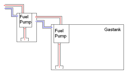

Hi All.
I need to make a fuel surge tank,becourse when ever i´m under a 1/2 tank of fuel and i accellerate hard,the car will misfire.
So i have planned to make a 4inch pipe,20cmm tall.
With a return at the top,but my Q is,
Can i rute the return line to the OE return hose,with at Tee,so i don´t have to take off the tank and make a hole in it,
Or will it mess it up,so it will not even return to that tank,and instead the return fuel from the engine ,is going to the surge tank.
Can You understand this`

06-29-2005, 09:39 PM
Fuel surge tank
Skassa,
Itn't it so that the normal return line is no longer hooked to your gastank but hooked to the surge tank and that a new line runs from your surge tank to where your fuel return line used to be?
06-29-2005, 09:45 PM
Fuel surge tank
It´s just that if i mount it like that,when ever the car is cruising,the fuel vill be heated in the surge tank,becourse it will run closedloop,so i don´t think that is a good idea.

06-29-2005, 09:54 PM
Fuel surge tank
Yeah cause I would think it should be hooked up like I drew.
Fuel from the fuel tank is pumped into the surge tank, if its full it cycles back into the fuel tank.
The second pump gets it from the smaller surge tank and brings it to the engine.
If it works well the surge tank should always be near full.
I guess to perfect it your would need a switch that when the surge tank is full the fuel pump in the gas tank stops working else indeed you would be pumping around massive amounts of fuel and heating it up. Then again, that isn't really that different from running your engine at idle with a single fuel pump I think...
06-29-2005, 10:07 PM
Fuel surge tank
Okay ,
I will make it like this,it´s really easy to do,so i will fabricate it in the weekend.
Thanks,
Skassa

quite easy to make it work -
although - PLZ do NOT forget to fit an filter between catchtank & extra pump - i forgot this & ruined a perfectly good Volvo T5-R pump.
Now i will run an EVO6 pump.

06-30-2005, 08:45 AM
Fuel surge tank
Kristian,
Is it me or do you have a couple more lines then in my diagram?Smile
You do seem to have the pump external to the surge tank so that could be the difference...
Knudsen, if you can weld up a surge tank that fits a stock pump, that would be coolSmile
