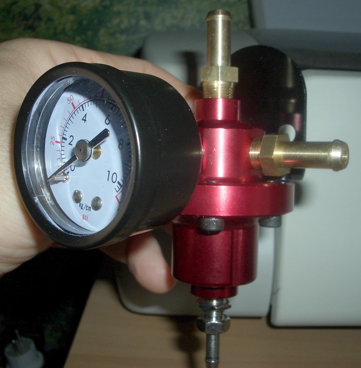

Finally bought that fuel pressure regulator on Ebay . But I have question.
I don't know how to locate the in and out hose on fuel regulator .
Does anyone knows which hose to fix to injectors rail the one on top or the one at side .
My second question; the nut at the bottom of regulator is for pressure regulation, but there is a hose there too. I don't know where to fix that hose to on engine?
Any help or advices welcome
Filh
Filh
Save the RWD cars
05-06-2005, 09:59 PM
Fuel Pressure regulator
The hose connects to a vacuum source. Preferably the same hose that the original regulator was attached to.
