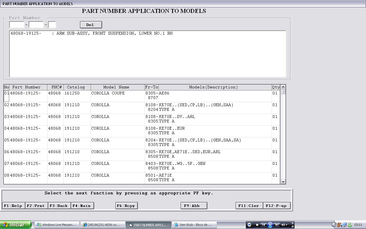

I did the homework before putting a TE70 front arm in my AE86. At eye, nothing is diferent. By the epc its excatly the same part number, why should they be diferent? I´ll try to take some pictures this weekend.
I leave some cross refernce.
RH - 48068-19125
LH - 48069-19105

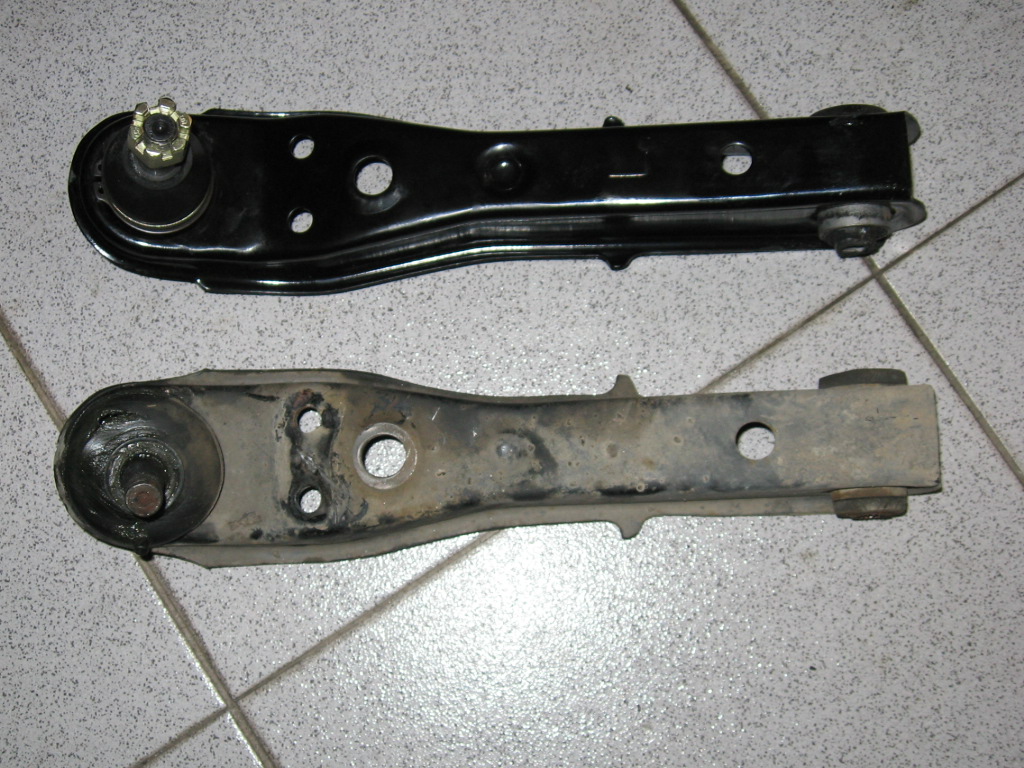

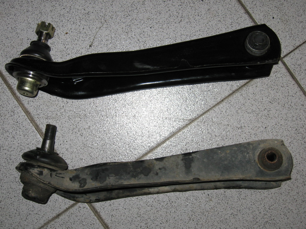

05-28-2007, 02:46 PM
Front arm - Price
Check it out.
[Image: AEU86 AE86 - Front arm - Price]
Cump´s
Filipe Oliveira
05-28-2007, 03:11 PM
Front arm - Price
So they are the same. Excellent! Smile
