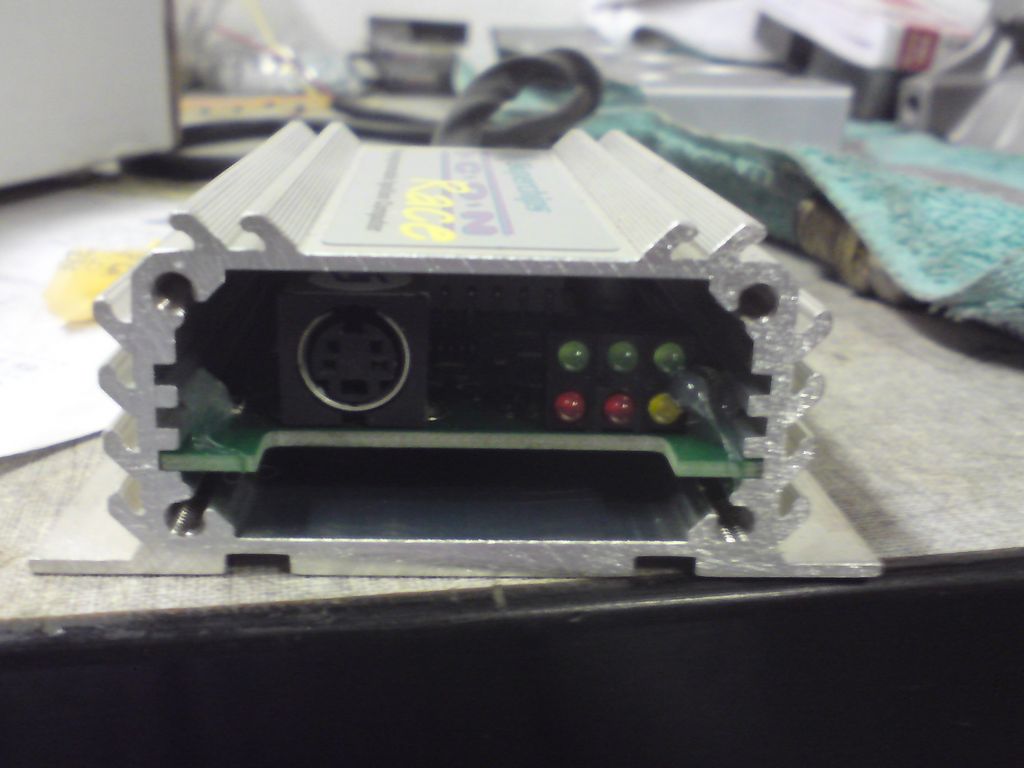

Do u really talk about the same chip like me? So how im able to programm it? There is nothing to plug in at the chip.
[img name=]http://www.aeu86.org/files/cc/ccf24012009_00007_117.jpg[/img]
Fensport text:
Reprogrammes your engines Ignition Advance Curve giving approximately 8 BHP increase at 4,500rpm. Improved Power/Torque and throttle response From 3,000rpm, Easily fitted into wiring loom just ahead of ecu.
How do i wire it up to the ecu? If there is still the plug of the harness.

The Superchip Icon Race unit you have can be re-programmed using the software available here:
http://s140507977.onlinehome.fr/IconRace...lation.zip
this download may not work however.
If not you can contact Superchips in the U.K and the software should be available free directly from them.
You will find the programming port and some LED indicators inside the unit, just take off the cover (four screws)
You will also need need the programming lead, again available from Superchips. £25 when I last enquired.

Now i almost know, what i have to do. I sent a mail to superchip.uk and asked the for a software and lead. The seller where i bought it told me, its for a 4age, maybe its aready programmed for this engine. Ill see it if i get an answer of superchip.uk
Actually wires and looms are totally not my thing. So please excuse my dumb questions! Im still wondering, how i plug the superchip to the ecu? Wiringharnessplugs are closed on the back so i cant go thru the plug. right? Do i need some plugs or how does it works?
01-27-2009, 09:47 PM
Fensport 4age superchip
O.K Roadrunner, the plug inside the unit is just for programming so it's not needed to actually fit to the car.
Basically the wires coming out of the unit are what you use.
Take the coil + wire off of your coil and attach it to the yellow / black wire and attach the yellow wire to the coil + connection. Red wire is used to power the unit (12v) and the black wire goes to earth. That's it really.
There is a way to check operation of the unit via the internal led's.
Superchips should confirm the checking operation and tell you how it works.
01-28-2009, 12:57 AM
Now i got it...! Thumbs up!
So i should place it next to the coil somewhere.
I think its aready programmed for the 4age.
[img name=]http://www.aeu86.org/files/tn/tn_dsc02007_307.jpg[/img]
Thanks again for your help!! I really appreciate that!
