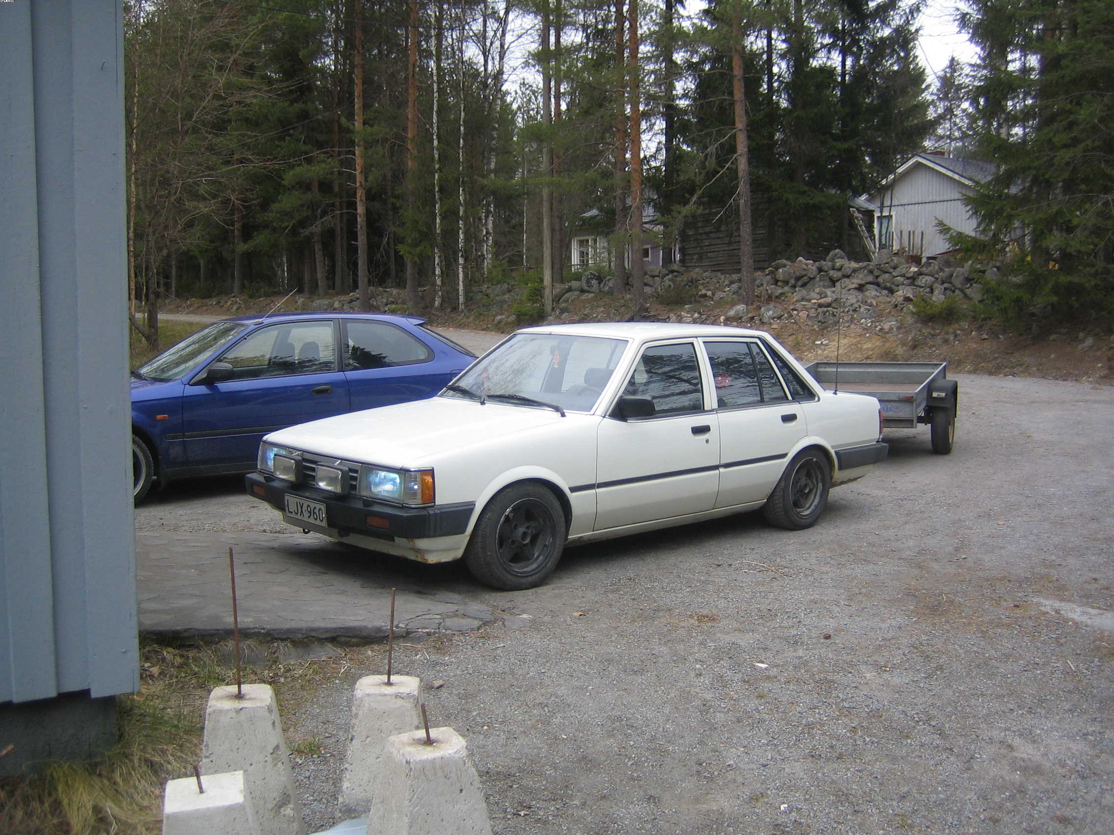

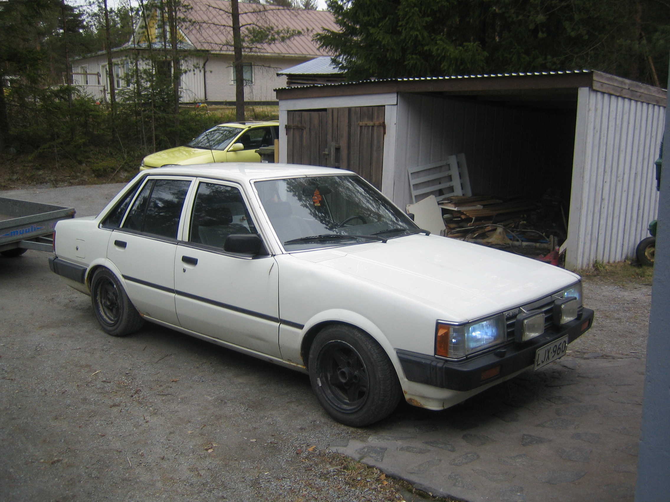

Fender flares on a 4-door?
Daihatsu Charmant 1,3 -87
Shortened Volvo XC70 rear springs in the front,original shortened springs in the rear,black paintes 14x7 alloys with 185/60 14 tires and 12000K Bi-xenon lights and also 12000K Xenons in the extra lights,so yes,I do find home though it is dark! Smile
I have a 4A-GE and 5-speed transmission waiting to get installed and also a LSD rear axle from a diesel vanette,probably known as Serena for you!
So maybe some day this car will go Sideways! Wink
Here's some pictures taken today!
Enjoy Thumbs up!
And about the fender flares on a 4-door,anybody done this??
